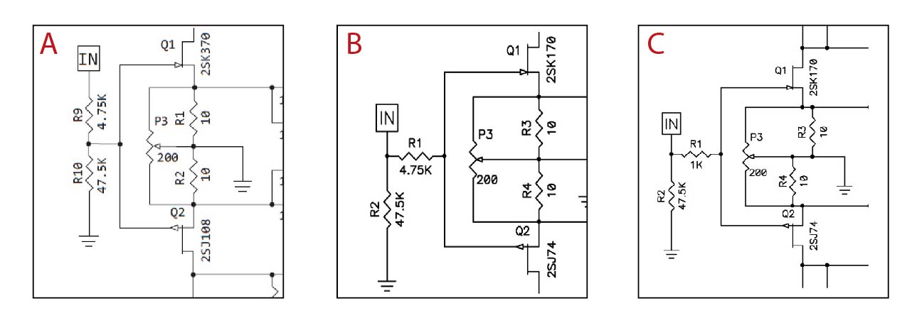

Hallo, I’m very confused. I did not understand what is the best solution for the entry stage for my F5 (A - B -C?).
My intention is to put a preamp before F5.
What is the best solution:
Bride of Zen preamp (with 15db gain)
B1 (only buffer).
My loudspeakers are:
AB2 | PMC Loudspeakers
Many thanks

I believe "A" is the schematic for the boards from the DIYaudio store. If you use those boards, which you probably should, you will have to use "A".
With those speakers you want gain in the preamp. I would say the B1 is not the best choice unless you listen at low volumes only. BA-3 might be a good choice as well, boards available from store.
Lot's of different flavors of preamps on this forum...BOZ uses very high voltage rails which limits your ability to experiment with other preamp designs later.
I have heard those PMC speakers. I like them a lot. It's a very lively speaker though and the F5 is a lively amplifier which may effect your decision on what to build for a preamp.
Depends...
If you drive the F5 (15,3dB gain) to output 25Wrms into 8 Ohms you'll need an input voltage of 2,4Vrms.
Most digital sources output between 2 and 3Vrms, 2Vrms being the implicit "standard". This output is at maximum possible output level. Mind you, many manufacturers set up their players with a relative high output level, as "louder is better" in a direct shootout in the shop. People tend to prefer the louder component in a direct A-B comparison. Sales BS that stays with you for the rest of your player's life.
That's why level matching is so important in ABX testing Call it the "loudness war for audio equipment" if you like.
So if your source components are loud enough the B1 could be a healthy choice. Just keep in mind that all amplification that is destroyed by the volume control will give you by-products of gain that you effectively do not need.
My speakers are around 88dB efficiency (Accuton C2-220, C2-79 and C2-12 units) and my B1/F5 combination plays more than loud enough getting it's signal from a Blue Sound Node 2. I have to crank the volume open a lot more than usual (between 12 and 3 o'clock) but that doesn't worry me. 🙂
I had the Mezmerize preamp connected to my F5 and I couldn't get enough volume for normal listening when playing a quiet classical CD.
Right now I'm using a Marantz AVR (zone 2 analog) as a preamp and normally have the volume around 8/10 to drive the F5 at good volume. My speakers are rated 90dB efficiency.
