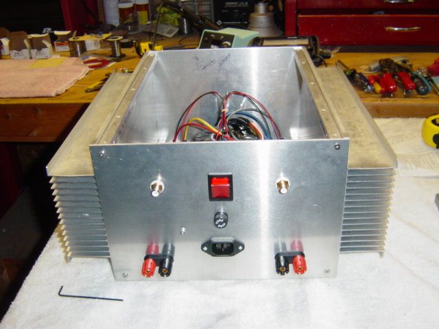

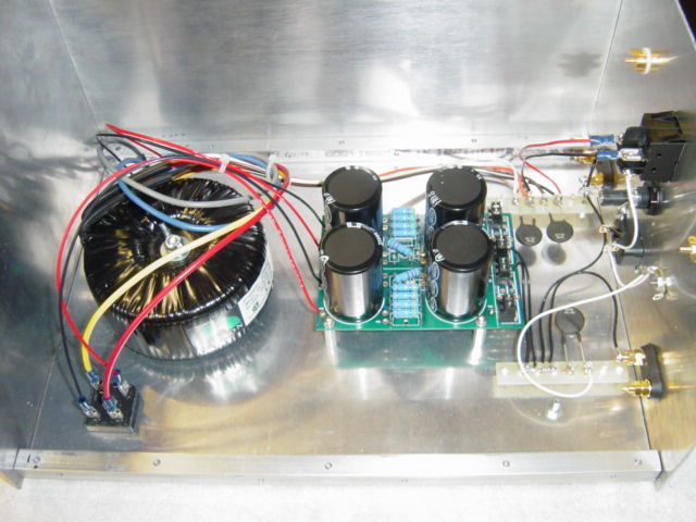

here are a couple of pics of my F5 "mule" amp. this was done on the cheap and made to be able to take apart and fiddle with-going to attempt P2P boards this weekend!
