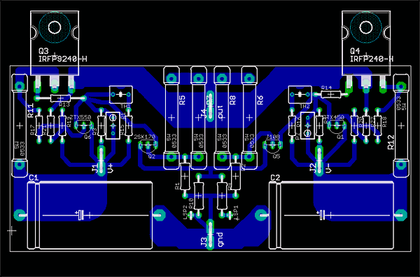

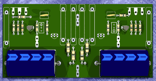

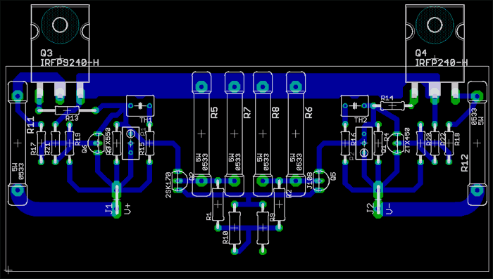

Has anyone come up with replacements for te 2sk170 and 2sj108... and the one alternative given for each by Nelson?
My boards are 55mm x 130mm, virtualy fully semetrical, with the outputs about 100mm appart.
The 2sj108 and its alternative specificaly seem to be hard to find...
I would perhaps move the power supply connections to the bottom left and right corners to aviod any voltage difference between the common nodes of the MOSFET source resistor and the JFET drain resistors. Also makes it easy to double up to a balanced on one PCB. And for that matter perhaps use a soldered jumper to connect the 10R (for which I use 3x 33R 0.25W in parallel) JFET source resistors to Gnd, which allows you to convert to an X-Balanced later. All options then open.
Otherwise quite well done, I thought.

Hi thanks for the reply...
I thought about cornering the two power points, but decided to stick with the stared layout giving all components accesing those nodes, connection at a single (reference) point, in the same way you might be used to seeing ground stars. It has the benefit of not makeing high and low current paths shareing the same tracks... (Quieter operation)
I do not see myself going balanced soon, but I will try to find the balanced schematic in this long thread, to get a grasp of what you intended wit the 10R's.
Also, I still need to sim the boards to check dissipation etc, so it will likely still change a little...
