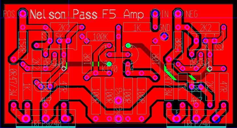

and of course the PCB for comments
Please, take a close look to the D and S legs of Q3.
>Why?
To chek the connections to these legs.
>what are they doing?
They are imitating role of Source follower.

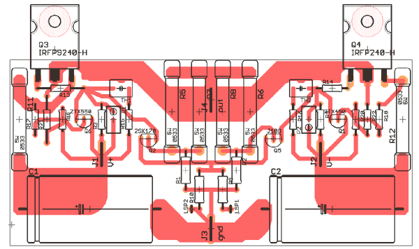

juma - is this good enough ?
here shown without upper and lower gnd plane
my first pb , made with PC - ever !
Kicad proggie
for audiofanatic
it seems to me that distance from MOSFET to heatsink could be more than the length of the pins. Depends on the positions of PCB and heatsinks. Consider to move MOSFETS closer to the edge of the PCB.
Ladislav
Ladislav

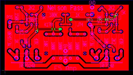

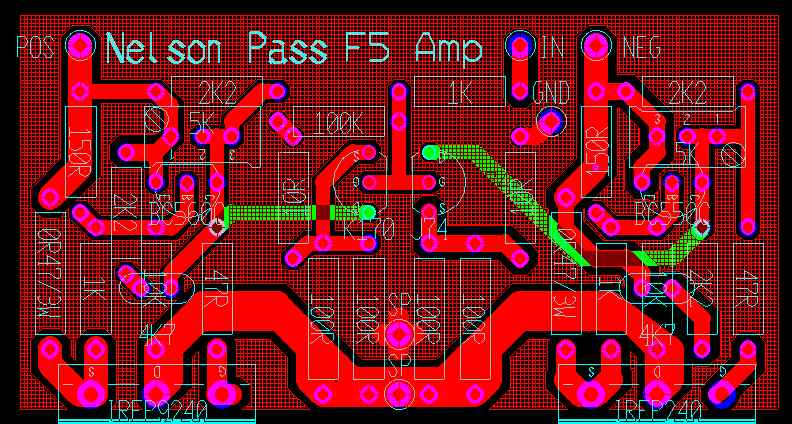

I dont think your pcb makes the requirement of the two 10r meeting at ground. Maybe it does and I am missing it.
Your left 10r and 100k meet but not at ground as in the schematic. I think you might need a ground trace running on bottom layer from 10r to 10r.
If I am wrong please burn me at the stake.

f5 pcb
Maybe the top SP connections are supposed to be the Speaker -, not sure, looks like a star or cross here. Doesnt ground at 10ohm ends like the AX schematic however as UDaily sayz.
Looks like the green traces are bottom side. I do like the layout.
