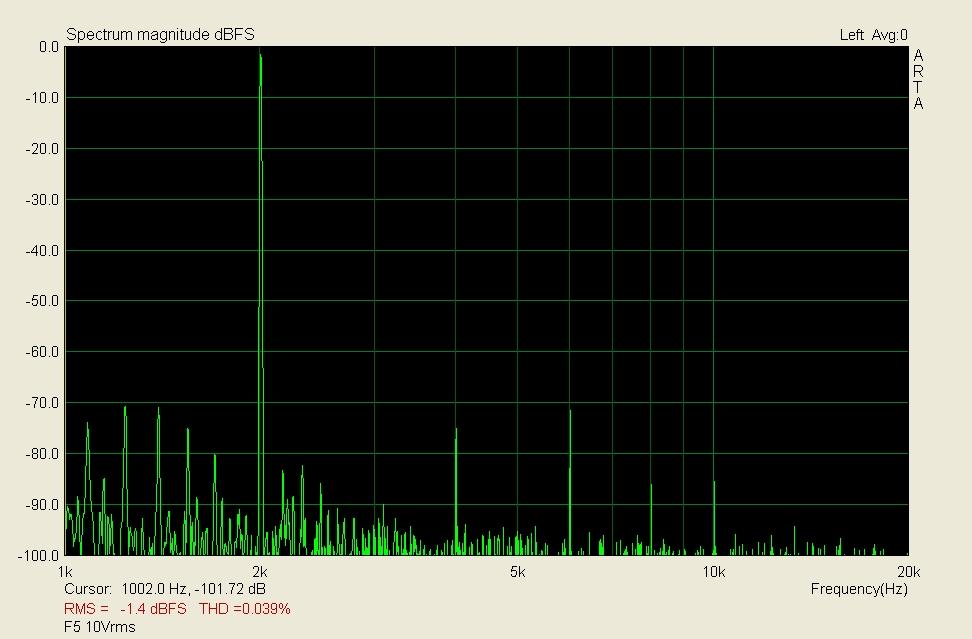

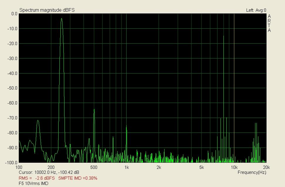

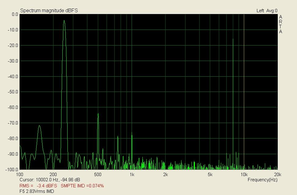

I will try to measure distortion with and without, but I remember THD is very close. The power resistors are Vishay dale 0,5Ω/5W and all the rest (except feedback) are vishay dale 1,4W metal film. Indeed the amplifier current drifts upwards after some time from 1,25A to 1,4A.
