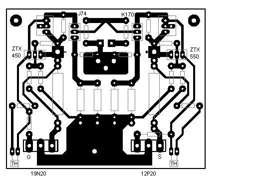

Allright, I have built and tested F5 for some 3 weeks now. Everything is in spec, fets are well matched, harmonics as they should, THD the same and DC offset less than 1 mV. Initial sound testing was done without thermistors and current limiting transistors and the outcome was very promising. On day 4, I added thermistors (EPCOS NTC 4k7 3%) and limiters and reajusted the bias. I took measurements and everything was spot on again. I used the amp for about 2 weeks driving my horn loaded Tannoy 385s but to my astonishment the bass was a lot less satisfying than before and the mid-highs were congested with no lifelike presentation, overall a very typical transistor mediocre sound. After two dissapointing weeks, I took off the thermistors again and readjusted the amps. The sound improved considerably! the difference is huge, the sound is alot more live, with excellent bass control, life like mid and vocals and excellent resolution and crystal clear extension in highs.
I really cannot explain this really huge difference with the thermistors in the circuit which is not measurable at all, but it is very much there in auditioning the amp. What is worth mentioning is that a friend of mine built exactly the same amps(using the same PCBs and components) and his findings are exactly the same!
Any ideas-explanations are more than welcomed!

Indeed the THD is slightly lower with the thermistors in circuit. The thermistors are attached to the plastic side of the body of the output mosfets and track the temperature very well. Still the sound is by far superior without these. The difference in sound quality is huge and its not a matter of subjective taste or anything.
For reference, I am posting my pcbs, I know the mosfets are very close to each other but it was designed this way in order to be mounted on specific narrow heatsinks.

PCB
The high current Source resistors are close and parallel to the TH tracks. It is better to put these R11,12 with supply wires near output mosfets, away from input components.
The rule is: same route for supply currents entering the mosfets - same route them to the speakers.

Maybe there is something not so great with the layout somehow?
Maybe posting resistor type, wattage, position etc may be insightful. It looks like your source resistors are pretty large. Most would think part types make not so much difference, but maybe the layout here is making the resistance value there in need of some 'dialing in'.
