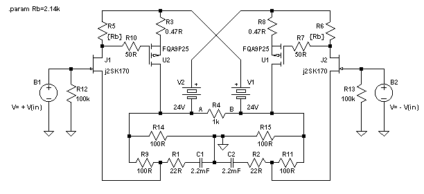

Had I not been still waiting for Fairchild MOSFETs, I would have built one without caps as per Circlomanen's circuit in post #1286. But maybe someone who spices regularly would care to do a quick sim, just to prove me wrong.
... which was just what I did before I posted my findings initially. Without the 22R and caps (and without source-to-source gain resistor) it is a buffer with no voltage gain. With those 22R, the voltage gain is 1+100R/22R=5.5 (and in my variant it is 1+22R/3.75R=6.9)
- Klaus
Which is what I would expect. So you are saying that I can just take out those caps and the circuit works, probably with a much lower value of JFET drain resistor.
But I wonder what difference in bandwidth and distortion does the 2200uF caps make on their own ?
Patrick
Basically yes, with proper adjustment of values and ratios of all of the resistors.
But, some new insights on the circlotron here (I had a gut feeling), there is a significant common mode problem at higher freqs (bias gets heavily modulated with higher odd order components), more or less regardless of topology details (that is, value of the GND load resistors and wether or not cap coupling or gain is used). This specific circlotron circuit is more tricky than it seems at first sight...
- Klaus
Using circlomanens circuit....

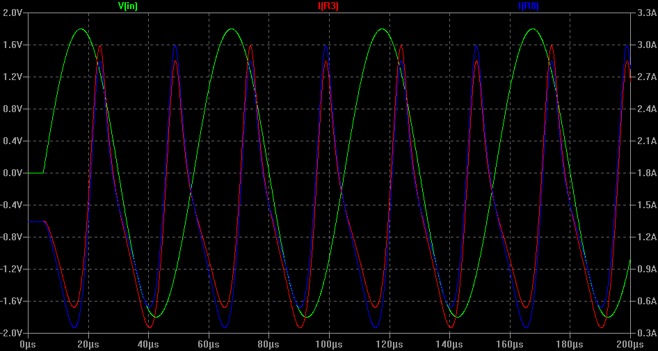

.... I get this response for the drain currents at 20kHz (and no speaker load, exept for those "bypasses" of (100R+100R)//(122R+122R). With 8R load it gets even nastier...
Distortion is accordingly high. BTW I tried cascoding the JFETs and buffering the MOSFET gate drive to lessen some capacitive effects, but to no avail. I'm quite puzzled about that behaviour.
- Klaus
