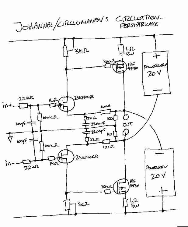

Although it was not discussed explicitly, it was hinted at multiple times that because of the assymetry between N & P devices for both JFETs and MOSFETs, the basic F5 circuit has to deviate from total symmetry (different MOSFET source resistors, different JFET drain resistors) between the upper and lower half, in order to get best distortion cancellation.
Then at the back of my mind, I thought I saw something at this forum before, with a similar topology, but only using only N JFETs and P MOSFETs. Of course that would be a circlotron, but like the F5 it also uses "current feedback", only that it is really perfectly symmetrical. Plus you get the balanced version using just 2 output devices :
http://www.diyaudio.com/forums/showthread.php?postid=489796#post489796
In my opinion, none of the caps are really necessarily. The actual resistor values, etc. might not be optimal, and you can probably also use P-JFETs and N-MOSFETs instead. But I do find the circuit very interesting, having built a variant of the balanced F5, and quite a number of circlotron type pre and power amps.
Patrick
Patrick

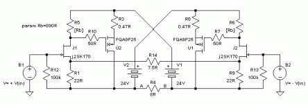

as shown the circuit, without caps, would only have unity gain (buffer), according to a quick sim it performs quite well as such up to 16Vpp differential input (16 Wrms) into 8R (THD 1kHz 0.01%) and pretty low Zout, with F5-style operating conditions (24V supplies, 1.3A bias). The bottom resistors are parallel to the load and no bias current flows through them, only load current, thus their value is not important.
You need a source-to-source feedback resistor to get some gain when you want to go without caps, either directly or with two resistors going to the opposite load points. For the first variant see attachment, this gives 25Wrms into 8R with a 3Vpp differential drive (and 32V Vds at the 170's). The nice thing is that it self-balances perfectly, you can ground on input and double up the drive condition at the other and get 100% identical circuit conditions. 1kHz distortion is not as good though (but I haven't try to tweak much), 0.12% at these conditions, Zout at about 200mR.
The second variant is slightly worse 0.17% and even more sensitive to slight source resistor mismatches (1% mismatch is enough to greatly disturb leg current balance). Note that the input resistors get "reverse bootstrapped" by the circuit gain, so 100k will give only resulting 19k Zin, per side. This can be fixed by proper bootstrapping (divider taps accros the load at the gain ratio).
Also note that this circuit (less the supply) is practically the top half of the circuit TimS posted here as his balanced F5 approach. Last not least the circuit is basically identical to the original from Circlomanen, since "GND" is nothing else than the load center point and placing DC-blocked resistors to that point is equivalent to coupling from source to source, preferably also with a blocking cap to get DC unity gain. His one sims, slightly better than my proposal, at 0.07%, because the I/V-resistor is three times bigger (and JFET Id three times lower, only 3mA). It doesn't have the self-balancing action, though (which needs the "floating" gate resistors to work).
- Klaus (lover of circlotrons)

Ah, sorry, forget about that. It will only work in the ideal world, or perhaps when battery powered and truly floating. Otherwise the smallest noise current mismatch in the 100k's will disturb everything...KSTR said:The nice thing is that it self-balances perfectly, you can ground on input and double up the drive condition at the other and get 100% identical circuit conditions.
- Klaus
I could not see any attachment for 1st & 2nd variant ....
Patrick
Patrick
