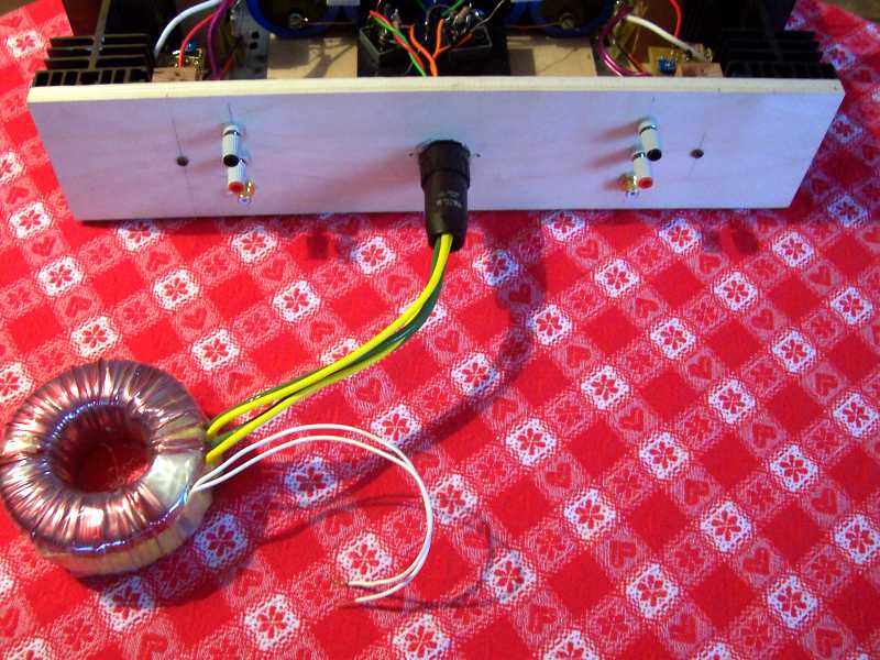

Anyway F5 is very very good . The next one I will match transistor and source resistors as I can and will see .
and this is my amp finished with connectors . The toroidal is 250 VA ,slightly underrated power . All the amp become very hot though , and some little computer fans are in order to cool down it .
Thanks .
