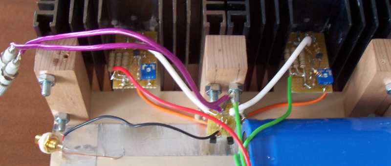

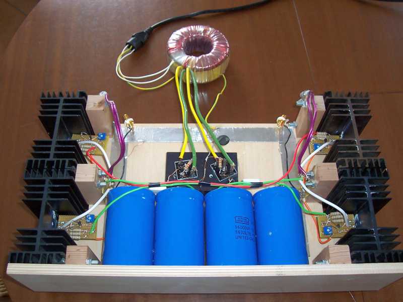

Hello ,
here 's my first F5 , builded as p2p little boards .
I didnt use the thermistor too and actually felt to replace R15 and TH1 ( same for R16 and TH2 ) by a 5,7 K ohm resistor to have similar gain .
The amp itself was very easy to set to proper operating values , I preferred to turn on the Nchannel mosfet first anyway ( dont ask me why ) .
It is all working ok AFAIK and guess the heat sinks stays at about 50 degrees , I can touch them for 5-6 seconds or so .
The capacitor bank are 2 *56000uF par rail filtered with 0.22ohm . So after a little playing with the ground the amp is very very quiet at the speakers . There is the Earth connection through a CL60 .

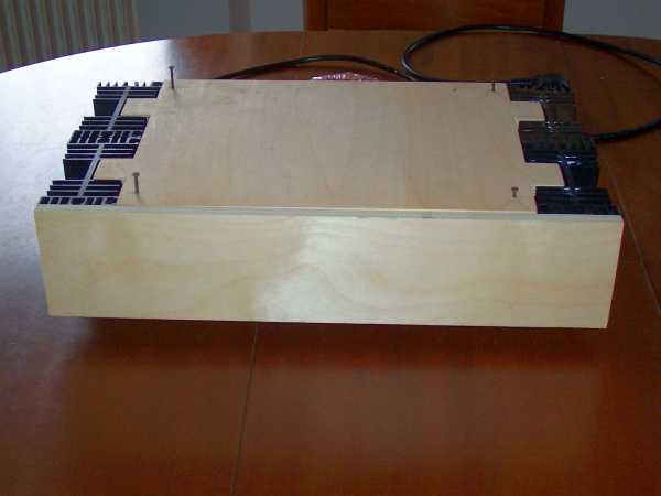

stefanobilliani said:
Oh the last picture shows how the complete will look like 🙂
and cant forget to say that I liked it pretty soon , was actually very involved in listening the system with a pair of Jordans in MLTL .
It is doing a nice JOB 🙂
few long slots on upper plate , same as on bottom plate , oriented as you like ........
and you can call it Woodie 😉
( and I can call it fugly! :clown: )
