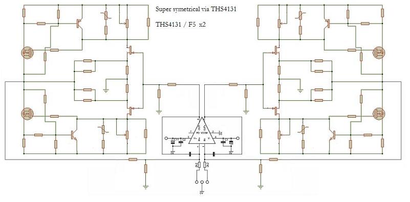

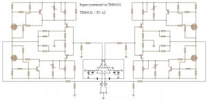

The WMF file attached is the balanced circuit as built, using 4x Toshiba MOSFETs :

> can you please post a schematics in higher resolution - it's not clear where the connections are (cross point in JFETs source resistors) and component values are unvisible ?
It is a Windows Metafile and not JPEG.
The resolution is only poor if you open it with a photo editor sort of program.
What you could do is save it first. Open a new Word document (A3 Landscape), "insert graphics from file", then you will see all details in the highest resolution you might ever need.
