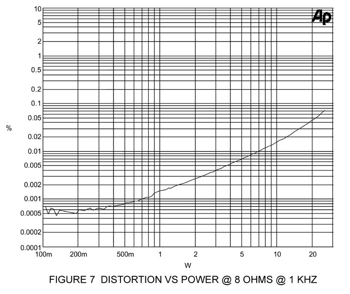

Here's the curve from the article.

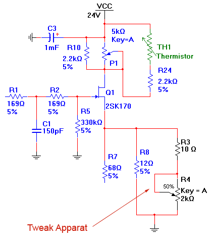

Audiorob -- your distortion numbers are high compared to those I experience. If you can, short the inputs and let us know how much noise you see on the output. It should be some tens of microvolts. (NP said 30uV in the article). If you are using a bench supply you might be picking up noise from your power supply leads. If your distortion analyzer has the functionality, switch in the 400Hz high pass filter and see how much garbage you're picking up from the power supply.
Udailey -- I am using the Cantherm thermistors -- they work fine. A little heat shrink tubing on the leads will allay your fears that their leads will come into contact with the power supply or heat sink. You can use a little GE RTV#162 (non-corrosive silicone sealant) or JB Weld 8265 to attach the thermistor to the device or to the heatsink.
To tweak I use the setup in the attachment -- it gives me a range of about 5.5 to 12R -- I start out with 68R//12R = 10.2R, then adjust the pot for 10.2R and lift the ground leg of the 68R. Twiddle the pot until the best THD% is achieved. It's easiest if you can look at the distortion residuals on a spectrum analyzer -- as you twiddle the pot the 2nd and 3rd harmonic relationships change.
I got in a batch of low ohm resistors to see if I could tweak the output resistors -- that's next on the agenda.
