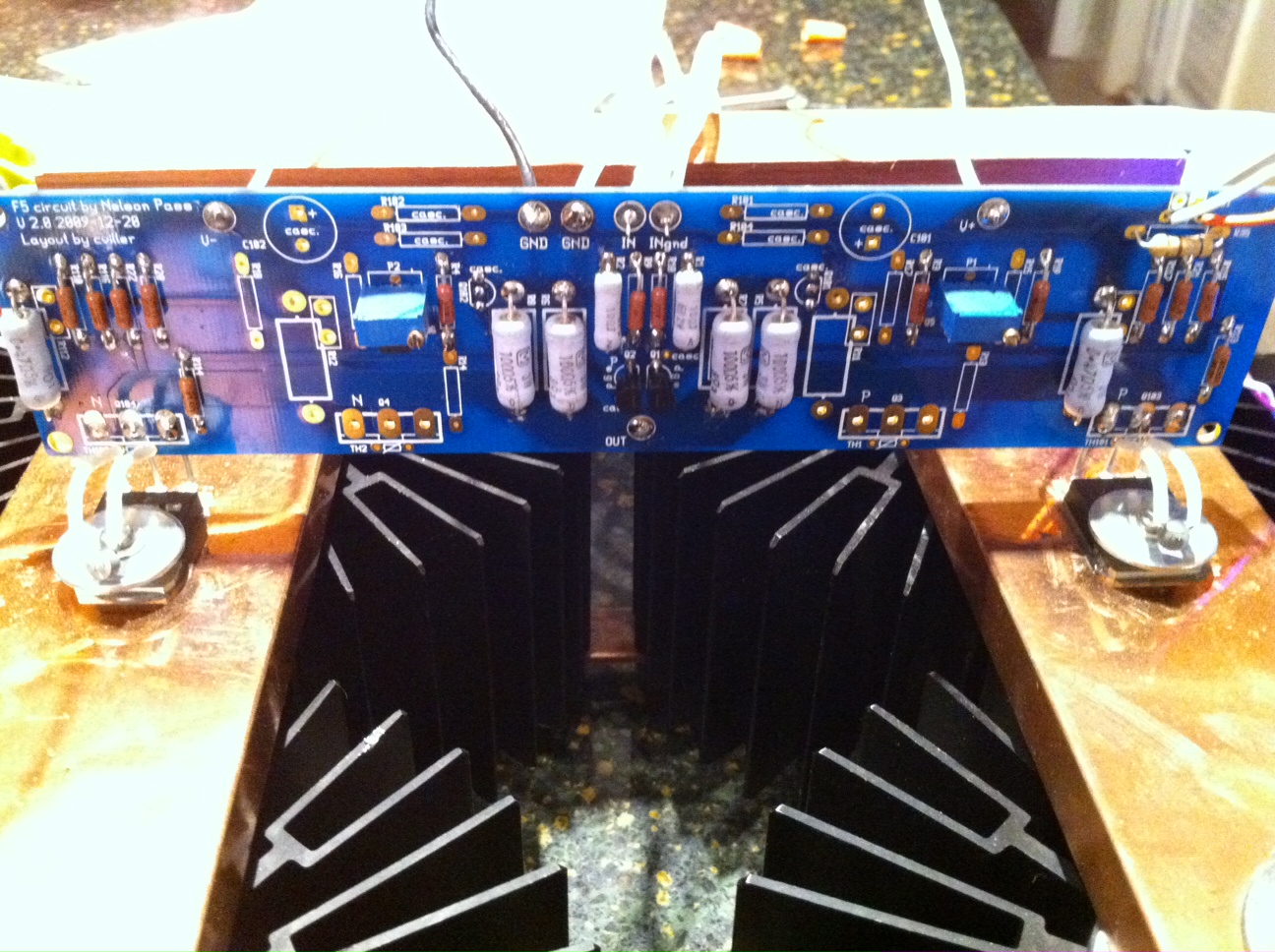

I have just started trying to bias my F5 mono blocks... only problem is I'm not seeing any voltage on my R111 R112 resistors. I have my pots turned to zero by checking across R3 and R4. When I turn them up the DC on the output changes but I see no voltage across R111 or R112. Same thing happens on both amps. I'm getting 25.5 volts at the board and the LED I have installed lights.
Any ideas what I should start checking first? These are Christians v2 boards from about a year ago.

check the limiting transistors. Maybe they are conducting (shorting). Some have inserted these the wrong way around/different type used.

Unless the boards are marked incorrectly, they (ZXT450/550) appear to be installed correctly. I also checked Q1 and 2 and they also look correct.

What is the max voltage over the drain resistor (thus P1/2)? If it is max 0,6 V check the pinout of the ztx's again . .. At 0,6V the IRF's just conduct a trickle.
- the DC changes so there is a loop - even if it is mA's.

Do you have something connected at Q101 & Q102 as there appears to be solder on the pads at there position?

If the Id starts to flow, but never reaches the threshold for the IRF to [really] conduct, then the Idss of the inputs (2sk170/2sj74) is too low --> raise the drain resistor, so the max voltage drop will increase.
I circumvented this type of problem by first determining the Vgs of the outputs and then (2) seeing - on the half-built board, no outputs yet - what the Vd referenced from the V+ or V- is. [Then you can swap resistor R3/4] You should be able to get the required Vgs at ease, then return P1/P2 to zero and connect the outputs.

Laff... I just look at the pictures and place the components... I have no practical knowledge about electronic circuits or what could be wrong. I guess I'll just buy another kit and try to replicate the process again and see if it works right the next time. Even a blind squirrel can find a nut if he looks long enough.

The ztx aren't compulsary. (limiters)
You could take them out and see if it works.
If it does work then it will mean they were wrongly wired.

I had originally installed them wrong when I installed them the first time. I pulled them and reinstalled them in the correct Q1/Q2 spots before i powered up the boards... I guess I could have over heated them by doing that. Should pull them and test them. Can anyone tell how to test the 170/j74 fets?

Seems like I remember an issue early on with the cviller boards and reverse orintation of the zetek devices? Its been a while, but it may bear checking it out.
