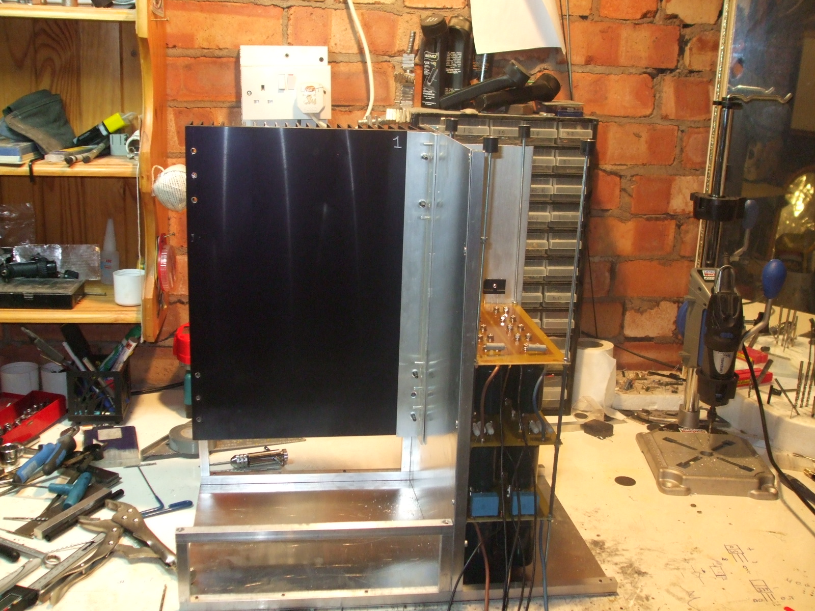

300X400x83 sinks just begghin to get hot.
PS (big secret) cost about £50 each + P&P and anodising cost:D

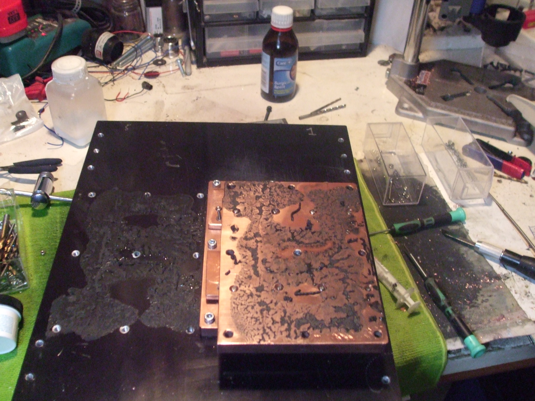

+ heat spreaders and 20 hours hand lapping and such.
Came from small firm in Italy (do not even know how credit card or Paypall works)
But can send invoice copy to selcted few if you ask.

Drill press fine for pilots then Just makita with piece of string as plumb bob.
Drilling copper is a right pain as it binds to blades and bits so yess Cee Vee is right.
(but then somebody that never done it would say that it is easy peasy)
If you got no drill press (she would go balistic if she see such a thing) get extra loads of decent drill bits and then duble up on that.
So a really realy orrible and boring and frustrating Job (about 20 hours just for heath spreders) but hey not getting paid to do such athing so yess give us same more.
PS I have so far mounted a few sets of Mosfets and still have not stripped a tread on the sinks. worth it?
IMO yess
Joined 2006
:cool:A drill press is really usefull because you can go down to very low speeds and still have decent torque to cut....and you can control pressure on the copper surface better.
It's the same problem with aluminium, just worse in copper because it heats up quicker.
Problem is that material becomes soft if not cooled and then the bit sticks and/or breaks.
So it is absolutely essential to keep material cool and harder for a decent cut.
Dremel is not a good idea because speed it too high, the bigger drill presses are much slower.
In my CNC i get arround this using cutting bits with only one cutting face, same as alu, this prevents soft material from stricking between cutting faces and seizing the bit.
Since there are no drill bits with only one face.....use slower speed.
