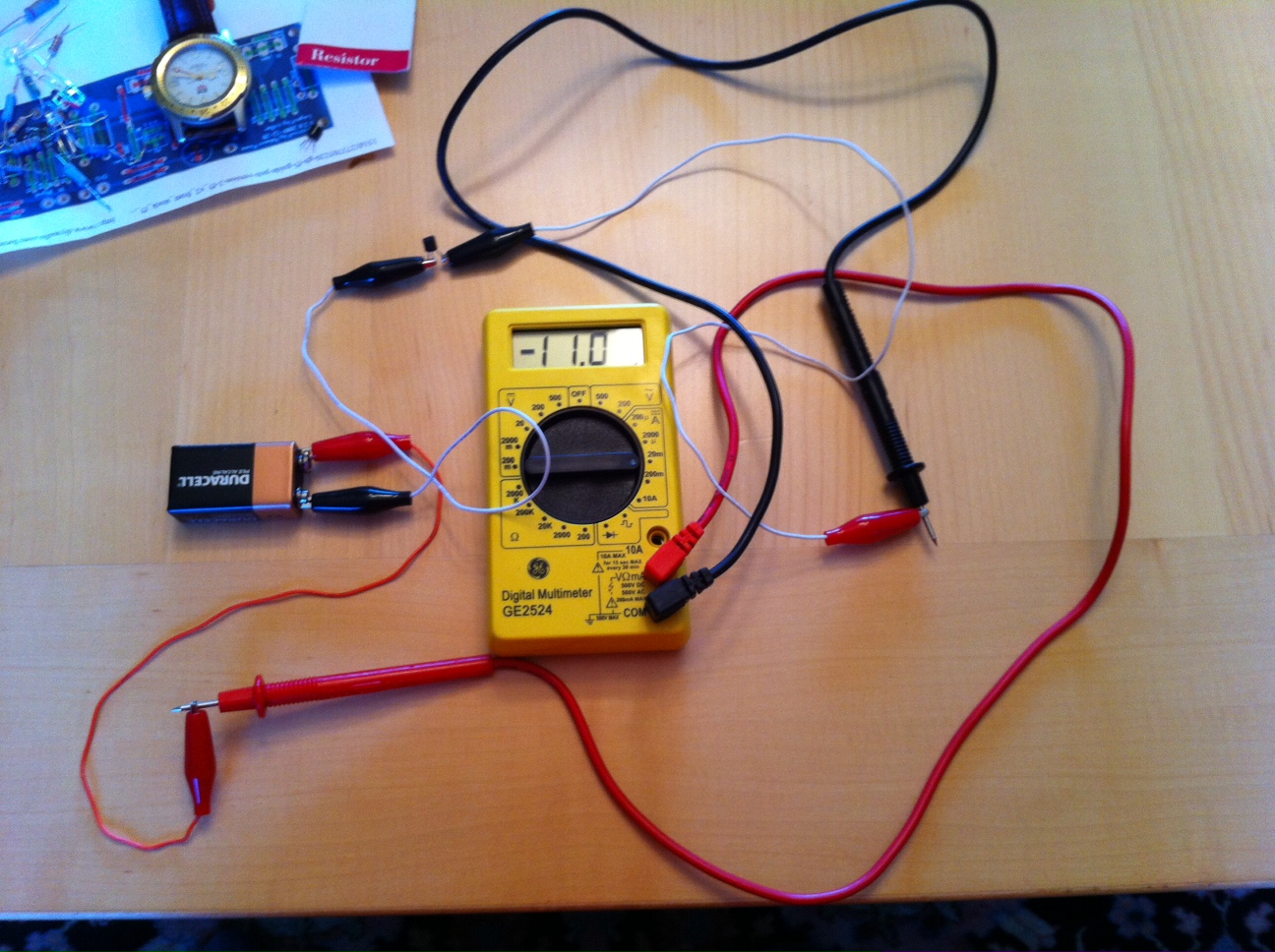

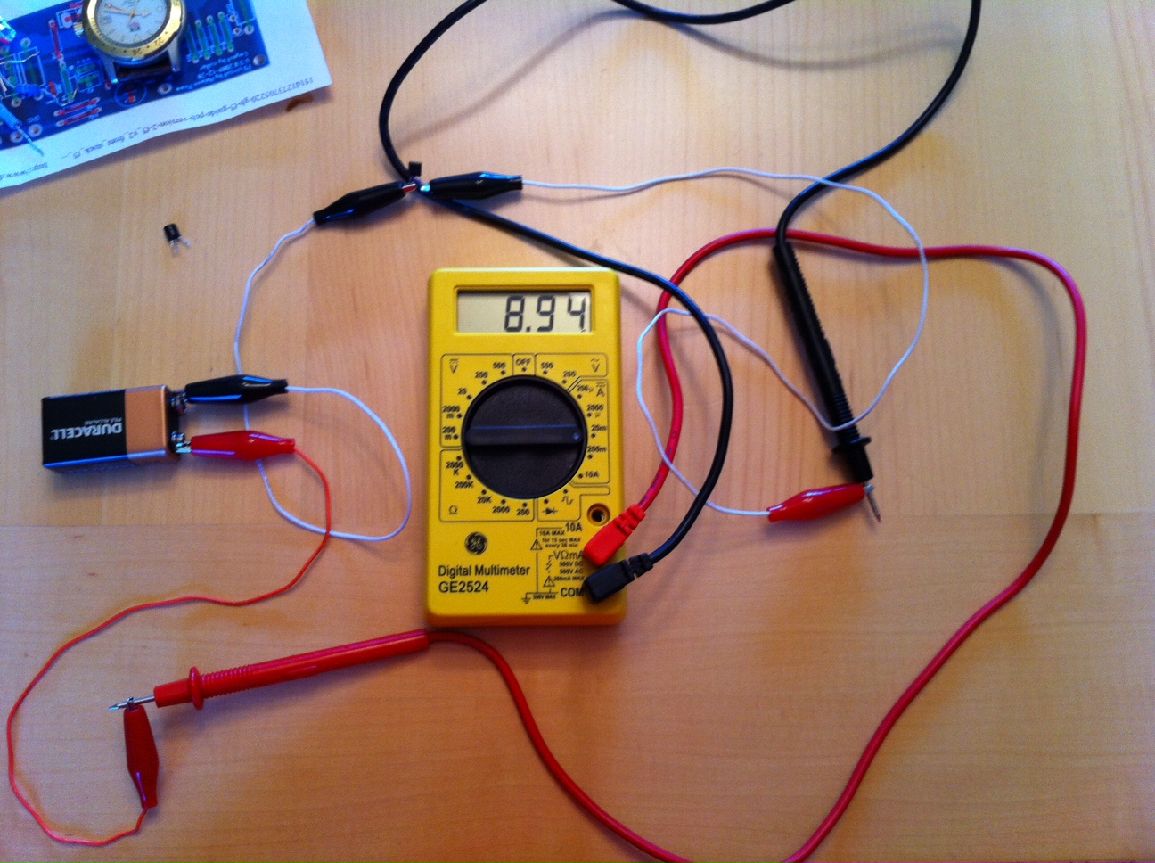

Using the method 6L6 supplied, I get 9.15 volts (new 9V batt voltage)... which I'm guessing means they are bad and I need new ones.
erpiii
look at post 11251.
you have omitted the resistor.
That resistor is there to allow you to measure the Vdrop across the resistor and that in turn allows you to calculate the current. In this case Idss current.
As said a little earlier, don't use a 1k0 with a 9V battery. Try 10r.
A 199.9mVdc scale on a DMM will allow a measurable current range through the 10r of 0.02mA to 19.9mA. That is sufficient to measure any gr or bl grade of k170 and will also measure most v grade.
You can use the same jig, with the same resistor, to measure j74. But one must reverse the battery connections to suit the Pchannel jFET.

Because your meter needs to be set to milliamps. 🙂
If your meter does not have that setting, then you need to add the resistor to the circuit, and read the voltage across it, to then compute the current draw.
I got a meter the guy said wold read ma. These are the readings I got. Are they correct or do I need to get new ones?
