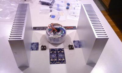

A bit of trimming on the offset and I hope to put this F5 amp together. Both channels have a bias of 1,2A, Vdc from power is 44v.

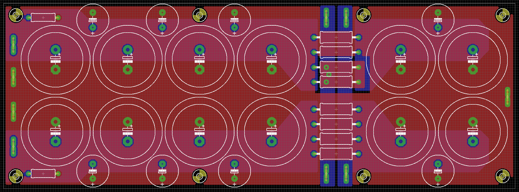

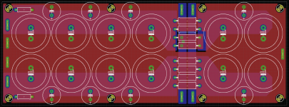

New CRC Supply. Based on Cvillers CRC supply, but with room for more caps.
The 3 small caps pr rail in the first C is to give a more total ripple current and secondly to lower the total ESR of the first C. The small cap in the second C is only there to lower the total ESR of the last C.
Big caps are 35 mm diameter, 10 mm pitch snap-ins, small caps are 16 mm diameter, 7,5 mm pitch leaded. Resistors are ment to be 5W resistors and lastly for connection to the PSU Fast on tabs are used.
A big board and unfortunately quite expensive to manufacture but what the hell, you only live once.
Ordering just 2 would cost around 25-30 Euro pr board. Once you get to 10 boards the price per board drops to 15 Euro or around that amount. Order 100 boards?, well, then they are almost laughably cheap.
The wonders of large scale manufacturing.
Big caps have lower esr than small ones. Same for ripple rating.
Four big caps will more than suffice for ripple managing.
The first three small caps will do little there.
Why not three big ones on each side of the resistor.
Don' be afraid by ripple in first caps, it is the RMS value of established ripple that counts.
In PSUD, delay the simulation by one second and look at RMS value, it is not so high.
Also, the ripple capability of a cap is way higher when it is cold.
Ripple rating is RMS value at rated temperature.

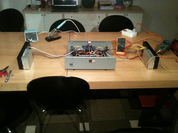

Well I fired my new F5 build up tonight and lo and behold, it actually worked with no hassle!!
I biased it up as far as 500mV - enough to prove it was working outside in the workshop. When I bring it into the house I'll need to trick about with the biasing a bit. Like myother build, this one has no protection/thermistors. But, I used 9240/240 in the other one, whereas I have fairchilds in this one. Also, I've bigger nicer transformers in this one. Both are dual mono in one chassis.
Photos to follow soon... this one is built on a alu head from a car engine. Big difference in temperature between the workshop and inside in the house (its final home) but at 500mV bias I could keep my fingers on the mosfet body - I'd estimate 50 degC. Given that its 20 deg warmer inside, it seems the head might... just might... work out as a heatsink for those of us working on the cheap.
Anyway, more testing to follow and more to discover about the heat dissipation from the head.
Fran
