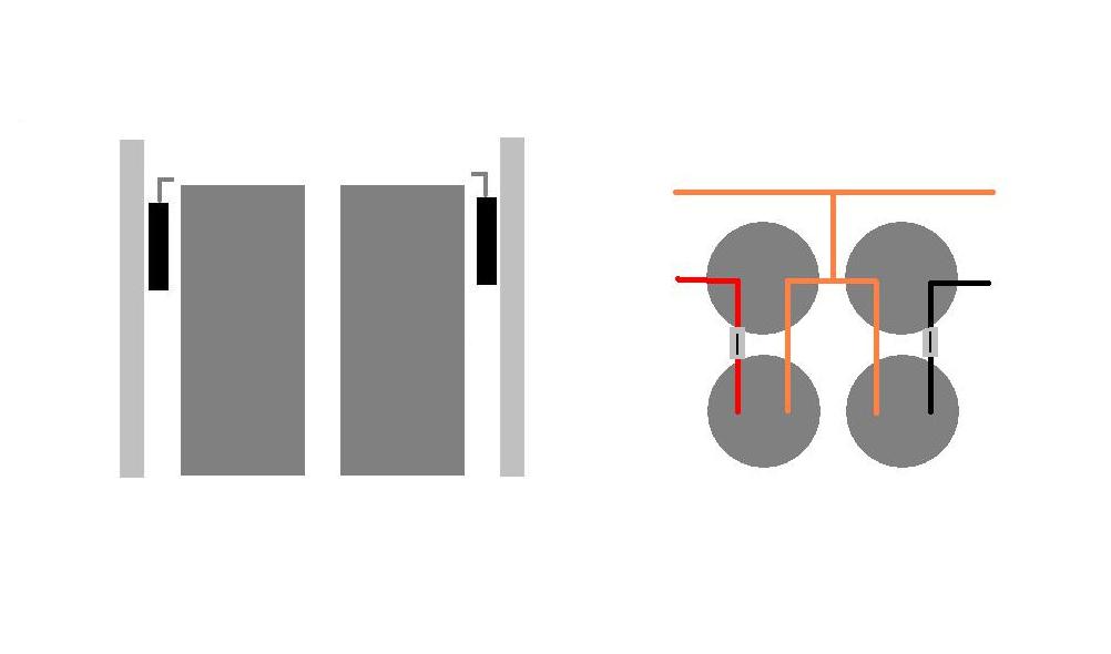

I thought I should follow my own advice and check Tinitus link he so kindly looked up for us.
I can't see any value specified for peak one shot current. There is not a defined symbol for that parameter.
T,
where does 13.5A comes from for ripple current?
I see 6.5A or 9.5A ripple capacity and when corrected for 100Hz this drops to ~4A.
On that basis 4//3900uF would give ~16A or 24A of continuous ripple capability.
T,

yeah, and the silly thing is that a single "small" screw cap only slightly bigger will do just that, or wrong again
Digi-Key - 495-4220-ND (Manufacturer - B41456B7109M)
hey Andrew, Im not arguing, but trying to understand
and theres an even tougher 55V, 17.5A, 125gr, though taken at 105gr
Digi-Key - 495-3701-ND (Manufacturer - B41605A0368M002)
but its a bit messey as this one isnt in the spec sheet either
but theres a similar one with same can size, but slightly more capacity
do I understand the frequency/current chart correctly, if I say that the 40V ø25mm can size derates with a 0.7 factor, and the 55V ø25x50mm derates with a 0.6 factor
btw, could you by mistake have taken the current rating at 125gr
the listed current seems to be at the 105gr rating, which is higher

I am slightly afraid of how much it would cost if I wanted to get the 15000µF capacitor in that series. A ripple current of 15.6A per capacitor at 100hz looks to be a bit excessive though.
yeah, but as of now I have decided not waste more time, and not worry about it

I and others have been saying for a long time that the first cap in a CRC and CLC must have a very high ripple rating.
I have recommended that a bank of paralleled cheap caps are the most economic way of providing that ripple capability. The smoothing of rectified AC to DC is a continuous duty. In a high bias amplifier (eg ClassA) that is a high ripple current and continuous duty. The caps will heat up. Keep them in a cool environment, probably at the bottom of a well ventilated amplifier. Design to meet the duty.

How little ripple voltage from a CRC supply would be considered good enough?
Thinking 0.5-1V peak-peak would be ok?

Generic FW PSU as per the F5 manual.
Below 0.4V peak-peak
> Doubling the last cap nearly halves it.
And also increases the ripple current by approx. 2x in the process.
