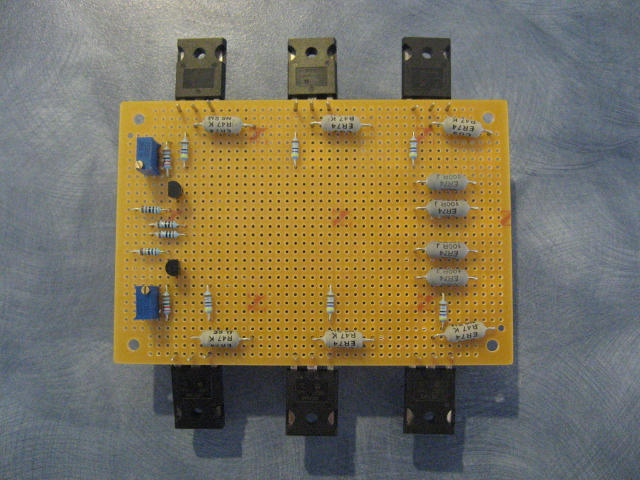

I built this sucker up ages ago. It is point to point on proto board with 3 pairs at the output.
It has been tested in the lab and been found to be completely stable under resistive and reactive loads.
It also sounds quite nice😎

Three pair output version I built up ages ago.
I had a chance to listen to Sting.
Looks fine, but I mean authentic point to point, no boards messing around.

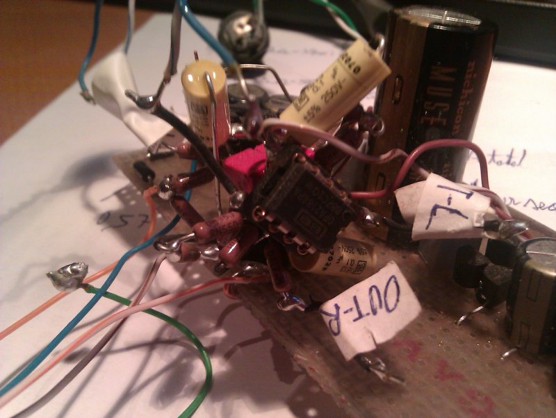

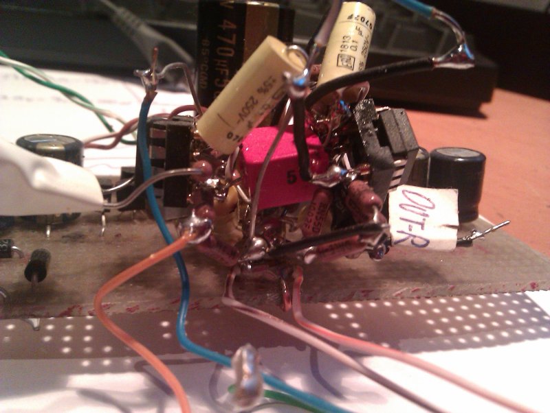

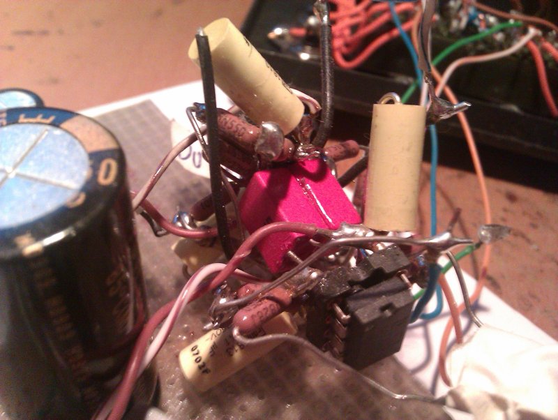

Attached is a (really integrated) preamp I made with OPA2134. There's a board for the big caps and the PSU, but it is there mainly for holding the ball of soldered components. With an F5 that is not needed because of the mosfets attached to the HS holding all the stuff.
Guess how does it sound 😀
Edit: In fact, it is a two stage preamp composed of 3x-gain-stage - pot - buffer

Peter Daniel has done some nice point to point work without the aid of a board. You might be able to get some ideas from him.

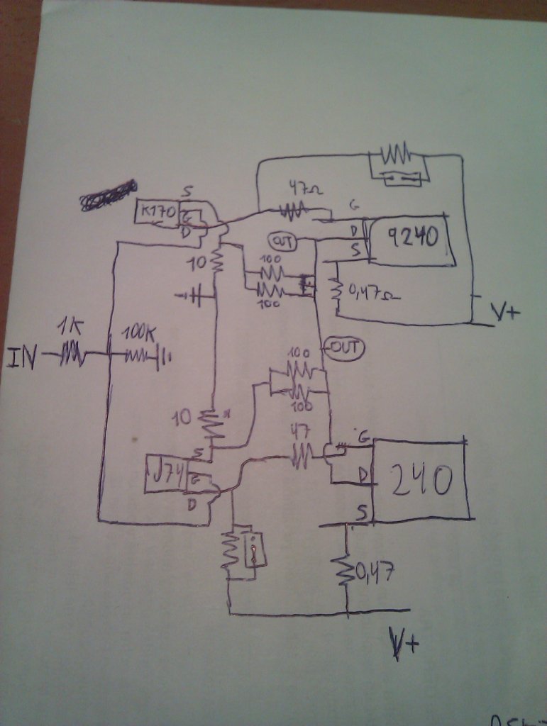

....thinking about the grounding arrangement...
thats the funny thing.....is there any
I have just drawn how the components would be layed down. More or less. Now take this image and try to tridimensionalize it, make the leads shorter and....thinking about the grounding arrangement...
Damn! not another F5! I've just built one![]()
You'd gain from thermally coupling the K170 and the J74 maybe 😎

Are all the other board components standard, or were there required changes for this increase in output devices?

All the values were kept the same.
However I left out current limiting circuit and biasing thermistors.
Excellent! I had no idea the circuit would drive that many outputs as is. Bias or other supply differences I suppose? Higher voltage rails? Larger heat sinks?
I'm getting ready to buy some more heatsinks, more F-5 amps need built, this sounds very interesting.
