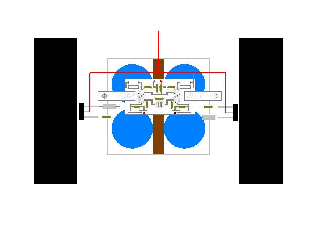

So, my F5 is almost complete, only the power connector is missing. I tried do make it "not so big" as the original idea was to make two monoblocks. Then the battle plan evolved as following. Please tell me if it makes sense.
I made a stereo built now with a 320 VA transformer. I love the sound. Soon I will have a balanced source, and I will try to use the stereo built in a balanced configuration. (Just connecting the two minus of the speakers together, and using each channel for each phase) If it sounds good balanced, I will build a second one. With a balanced source I should also have more gain than I need.
I am driving Sonus Faber Grand Piano with them.
I only hope I had more time to listen to that....after Christmas vacation.
Thanks to everybody for help,
Davide

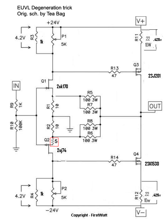

Advice on F5 with 2SK1530/2SJ201
I am planning another F5 build but with Toshiba MOSFETs. I have found the attached schematic in one of these threads. Just wanted to check if this is the right one that I am looking at? There seem to be so many discussions on this, just wasn't sure, which one.
Cheers
IF single ended (+/-24V rail) then R11, R12 should be 0R47.
And you should replace P1, P2 with fixed resistors after trimming.
Voltage across R3, R4 more like 3V.
Schematics not proven, so build at own risk.
Patrick
Should P1 and P2 behave any differently than a stock schematic to mandate replacement with fixed resistors? The reason I am asking is because that would be the case even in the case of IRFs isn't it? Or is it because of increased sensitivity of the Presets....with the combination of Toshiba Mosfets.
Thanks.
Thanks.
Merry Christmas to everyone!
Fixed resistors will exhibit less thermal drift, as their PPM temp. coefficient is smaller 🙂
Just choose the right type of resistors, some Dale RN/RL/CMF type should run just fine 😎
nAr
