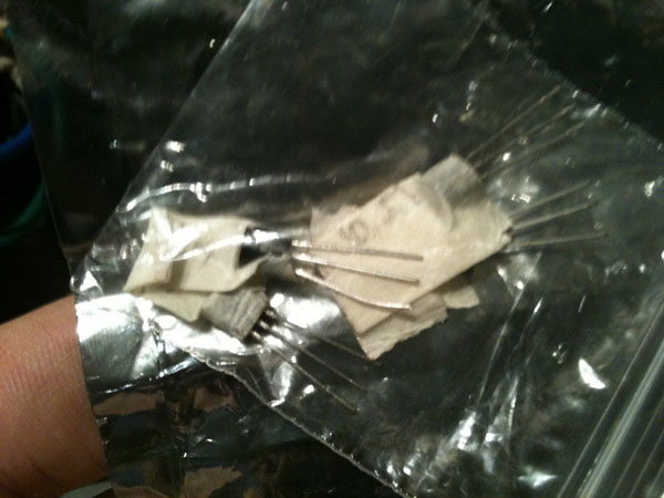

I had a friend help me match jfets for my F5 project. He made a circuit similar to the F5 on a test board and powered it from a 24V supply. We spent many hours registrering current thru the different jfets. We had them powered up for the same amount of time (about 4 minutes) and then reading off the voltage drop over a resistor. Ended up with two pairs of sk170bl/sj74. One pair was 6.11mA/ 6.08mA, the other 6,25mA/ 6,29mA. It was the best pair we could get from about 40 jfets total.
Is this methd ok and are my pairs a nice match for F5 now?

....Is this methd ok and are my pairs a nice match for F5 now?
Your JFETs are well matched

For more information about matching the Transconductance of the jfets, rather than just concentrating on their Idss, see Patricks post #8689 - requires an extra resistor.
And would suggest considering the effects of even a good Thermistor in parallel with the voltage gain resistors, plus the effect of a typical cermet pot on that same gain resistor.
I'm sure you have nice matches on your Jfets, but then you
will need exact matches on your P vs N channel Mosfets -
not probable.
This is why we have pots off the Drains of the Jfets and why
we also have a balance pot across the Sources of the Jfets.
