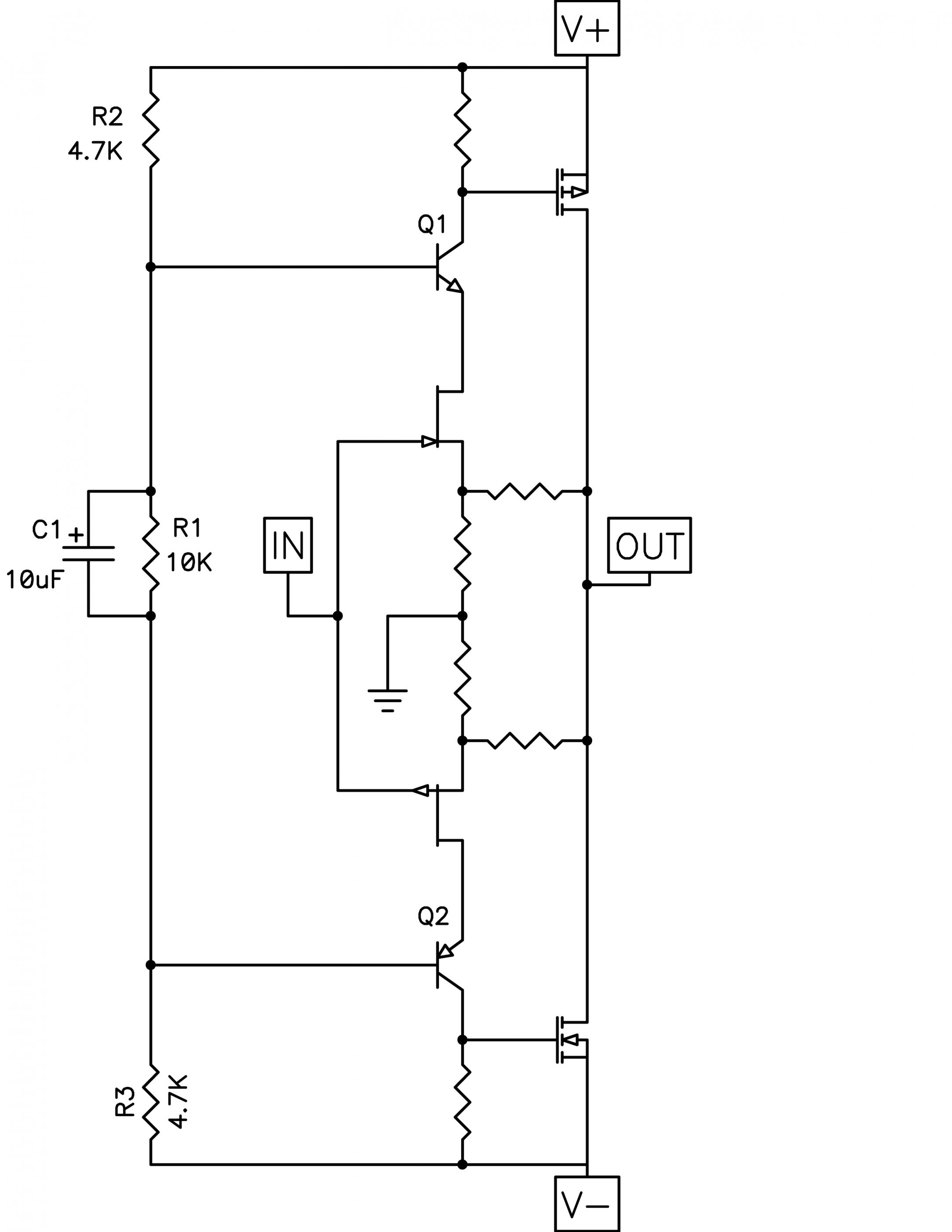

The reference is the Figure 6 in the "F5 Power Amplifier" article at "First Watt" website.

The bias trimpots specified for the F5 are 5k 0.5W
The maximum current for these is 10mApk. Ipk=sqrt(P/R) = sqrt(0.5 / 5000) = 0.01Apk
For longer life with AC signals we normally run them to <50% power rating, i.e. <7mApk = <5mAac.
Does any one have any references for DC current de-rating?
I suspect <<50% of power rating.

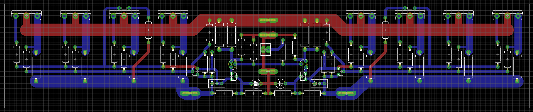

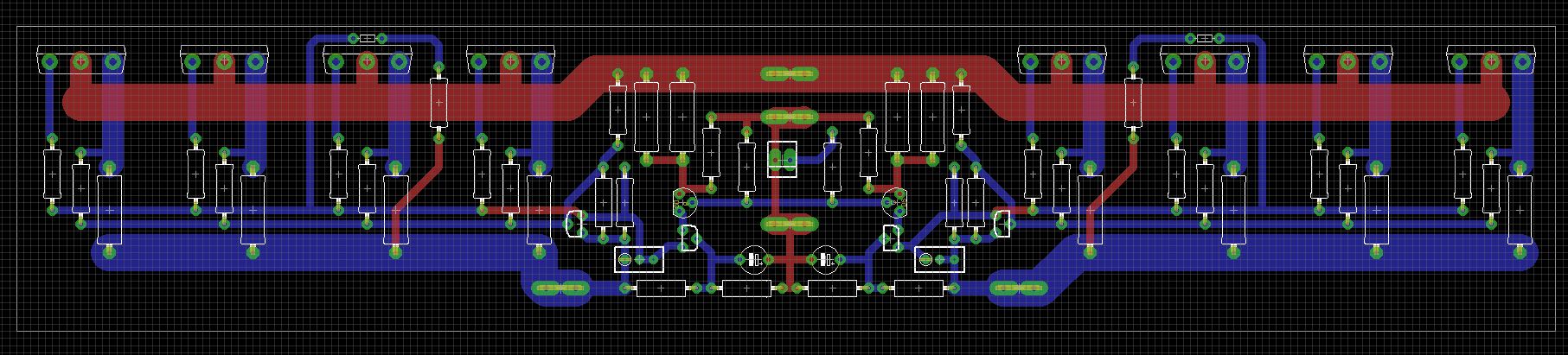

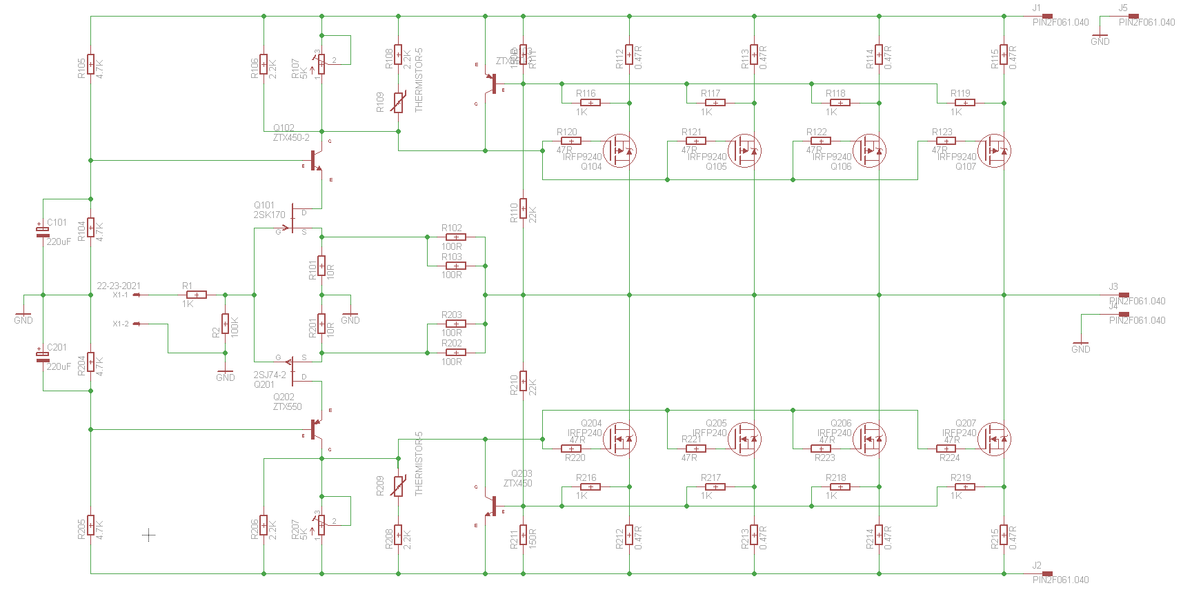

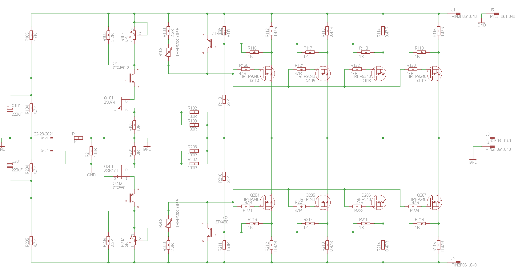

So I just made a schematic for F5 with cascoded input and 4 output pairs.:eek:
Used the same schematic from cvillers F5 scaled up with more outputs.
Layout is almost done but wouldnt mind a little input from the fine people on diyaudio. :)
Before I spend the time with the finishing touches and making gerbers.
But keep it constructive. :)

Just realised I made an error, reversed drain and source connection on 2SJ74, better get that fixed.
And some other stuff.:eek:
