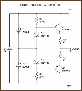

But there is very little current into the input ground.
The purpose is to settle the input voltage only.
The Quad solution has to deal with return speaker current.😕

I checked.
The Quad 306 is not a balanced amp and speaker return is to virtual ground.
Our case is different here.
We only need to state the input voltage commonly for the two legs..

it doesn't matter that 306 isn't balanced ; you have two "middle" points when amp is in idle - one is spk gnd ...... which is artificial ground produced with two bjt net ; but - same as that is virtual gnd , also amp output is virtual gnd , which is conveniently sliding up and down on potential scale , when we apply input signal
anyway - I wrote that things are critical more on academic level ..... where exactly that academic level is rising his ugly head - you can find if you try all these solutions
if you are enough precise in amplifier execution , you'll not have problems , whichever path you choose ;
point is - I'll sleep tighter , having firm gnd for every needed duty in an amp .
in any case - try and decide what's better / easier for you ....... we are chatting here with best intention , trying to see every piece of puzzle

I have been thinking to this last night.
You are right about , in my case, having to use the Quad active virtual ground.
I was forgetting the (low Z) feedabck current flowing to ground.
I will though add two diodes to cancel the dead zone corresponding to the two base emmitor junctions.
Thanks to have pointed that.
for reference
