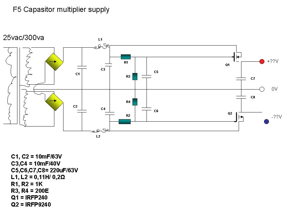

The voltage divider 1:5, so if Vin is 30 then Vout is 24. Is that right AndrewT?
I think I have the parts, so I could try this before buying a new trafo.
Cooling of the cap-multi mosfets would be 1,3A*6 = 8W

> The cap mult droping out 4v Zen Mod is speaking about (each rail needs one) is in Zen V9.
This is only true if you use IRFP MOsfets, the Vgs of which at the operating current is about 4V.
(And it is dropout per rail.)
There are other FETs with lower Vgs at the same current. Using Fairchild FETs FQP..... will drop a bit over 3V, using Semisouth JFETs hardly anything, using Toshiba 2SK1530-Y about 2.2V, and Toshiba 2SK1530-O (about 1.2V, if you can find them) even less.
So 4V is not holy number. (Sorry choky, I cannot resist.)
Patrick
PS I should add that the min. dropout voltage has to be larger than the ripple voltage at operating current, which depends on the size of the C's before the Cap Multiplier. Or else the regulator cannot regulate properly, as it can only regulate by dropping voltage.
> and with the Cmultipliers, the + & - rails don't come up to voltage at same rate,
If that is true then your R-C-R-C filter for the MOSFET gates are not slow enough (I normally design for 1~2 seconds) and the values are not matched, or the caps after the MOSFETs are also not matched. The transistors are quick enough and the small difference in speed will be dominated by those R-C's.
Patrick
