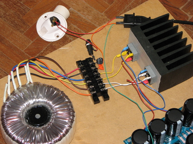

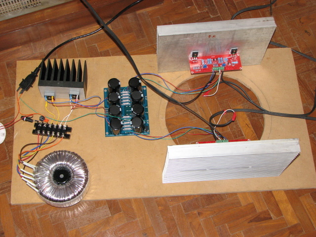

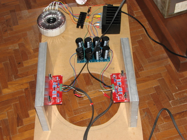

Thanks for all the help, I am enjoying my F5 build.
One thing that concerns me is that the R11 and R12 3W resistors are getting fairly hot. The Bias voltage is fairly stable at around 550mv across these resistors. No problem. Is there any danger that the resistors will reduce their resistance due to heat and have a "runaway" effect on the bias current?
Is this normal or should I change the resistors to a 5W wire wound to better tolerate the heat? As far as the sound of the amp is concerned, it is terrific.I have completed reading upto 670 pages of F5 postings. I do not remember the R11 and R12 heat discussion.
BTW, here are the pictures I promised earlier. I am now in the process of getting the chassis fabricated. Once that is done, I will move the F5 into it's new home.
Cheers.
Anil

what is the resistance value of R11/12 that you are using?
They should only dissipate ~650mW at quiescent.
Your main sinks will run cooler if you orient the fins to vertical.
The sink for the two bridge rectifiers is far too big. It will run cold, when as big as that.
Andrew,
The value of R11/R12 is 0.47ohms, 3 Watt. I suspect the resistors are not actually 3W but could be 2W. They are getting hot enough but maintaining the heat and not burning. The across the resistors is fairly stable at around 550mv.
In the chassis that I am getting built, the heatsinks are aligned vertically to dissipate more heat. Right now the test heatsinks are kept horizontally, as they don't stand vertically.
I am planning to mount the bridge rectifiers to the chassis and not use the heatsink shown in the picture. I am using that again as a part of the test setup, as I am worried that unmounted rectifiers could cause havoc.
Thanks for the advice.
Cheers.
Anil
Anil: I use the Ohmites in Jack's kit and they run around 50 degrees, which is pretty hot to touch but well within reason. I would say they are safe till about 70 degrees, which would be enough to burn your finger but it would still be fine for the resistor.
I use a small TO-220 heatsink stuck with thermal tape on the flat side of the resistors.
Anil: perhaps it's a bit late now, but R11 and R12 should be mounted with some clearance from the pcb. I haven't seen experienced any failure with a very large variety of 3W resistors here -- Panasonic, Ohmite, Caddock etc.
Thanks. It's not late. I can desolder and increase the clearance from the PCB. Meanwhile I will see if I can get some branded resistors like the ones you mentioned.
Sangram: Thanks. I realized that these resistors do get hot, but are still OK and perform well. I was initially concerned. I ran the amp in idle for 2 hours and then with music for 2 hours. The bias was pretty steady and no problem with the resistors. The heatsinks were pretty hot, I can touch it for around 3-4 seconds.
I will try and get some branded resistors and mount them with some clearance. I got hold of some 0.1 ohms, 3watt Dales in Bangalore. Does it make sense to parallel them and use?
Cheers.
Series you mean, parallel will drop the resistance even more 🙂 Yes, you could. I would use a temperature meter of some kind to check exactly how hot they get. Bangalore ambient is kinder to Class A electronics than over here.
I worry about your main heatsinks though, I feel they are really very small, the cooler weather notwithstanding. I hadn't seen them before and I hope you have better ones in the main case. These ones will be much better with a slow and quiet fan.
Good Luck 🙂
Good Luck 🙂
My bad. I mean series for the resistors. I am still in capacitance mode 🙂
The heatsinks are fairly large. In my chassis, I am going to increase the size and also mount them vertically. I will use a fan if there is no other option. I have access to lot of high quality and quite computer fans.
