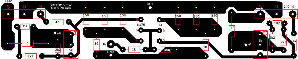

This is my compact F5 layout version, with some differences: no over-current protection (so it's not for people who tend to short-circuit amp's output), 3 x 150R/2W in GNFB network instead of 2 x 100R/3W (I have a large bag of 2 watt-ers).
After a HD crash I lost SprinLayout file, the .gif is all I have. It's a simple layout and can be easily reproduced in any PCB drawing software. It's copper side view, PCB size is 100 x 20 mm. TH1 and TH2 are 4k7 NTC resistors.

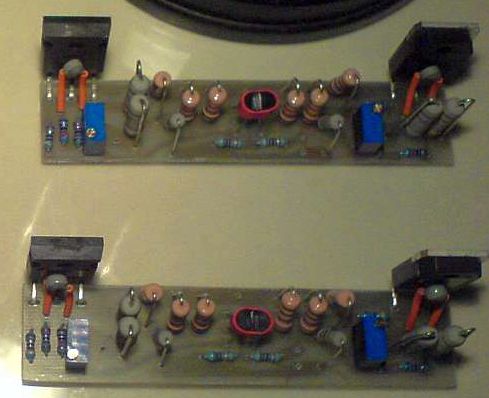

Need help with my F5 dual mosfet version...
the 240 side biased up with both 0.47 ohm resistors matching in mV...the 9240 side will not match. the one on the board reads half the voltage as the one off the board. I am using Peter Daniel's board.
I doublechecked the values of the source resistors and R13 and 14...all are correct.
This is most puzzling.
When I adjust the pot the values stay roughly at a 2:1 ratio.

The only other thing I can think that would not send both sides wacky is possibly the ZTX on the 9240 side gone bad?
They look nice yuma! I have never used pcb - software before and I guess there are lots of things you have to learn before using it successfully. I heard about services like this: http://http://cgi.ebay.com/Low-Cost-2-Layer-PCB-Manufacture-Service-1-5-boards-/230337719273?pt=LH_DefaultDomain_0&hash=item35a132abe9.
To start with, what is a gerber-based pcb file?
Sprint Layout is feature-rich, easy to use, intuitive to learn and cheap PCB software. I made my first PCB with it in a couple of hours after I installed it.
Gerber is a name for universal PCB-production file format (kind of a PDF for PCBs) widely supported by PCB software industry and PCB manufaturers.

This has been driving me mad all afternoon. I finally ended up pulling the 9240 out of the board and putting the 2 new 9240's in the channel. Funky enough...all is well. Both ends bias up so all 4 source resistors match.
All I can think is that the new vs old mosfets didnt like each other...especially in the 9240's.
So now for the right channel I have the broken in 9240's...of course now the 244's will misbehave for that side... LOL..
