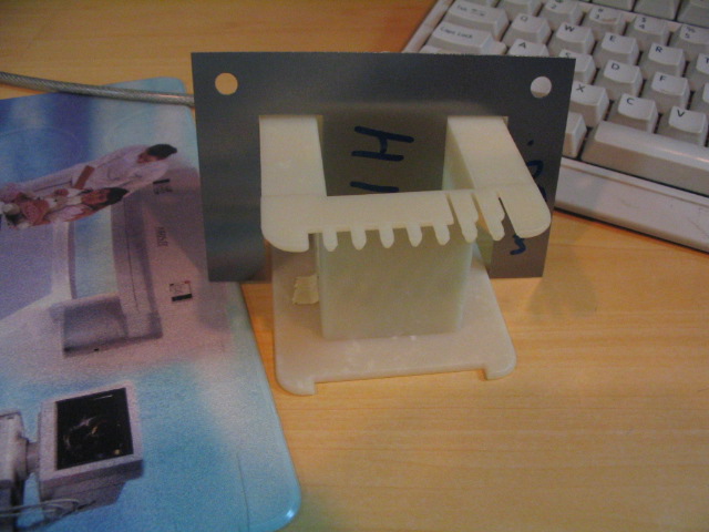

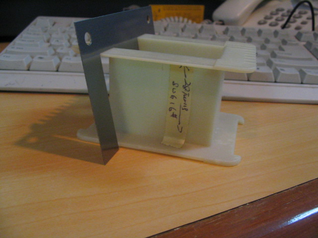

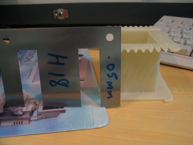

inductor for power supply
I intend to ask my neighbor who winds transformer as a living to wind an inductor to try out in the CLC the power supply .
The diameter of the bobbin is 20 cm and the height is 4.7 cm.
WE are going to use 16 g magnet wire and the iron core is made of H 18 --0.05 mm .
I estimate that about 5 metres of the wire can be wound in each bobbin.
I do not have an inductance meter.
Just want to know whether the project is sound in principle ?
Do i need to wind 2 inductors ?

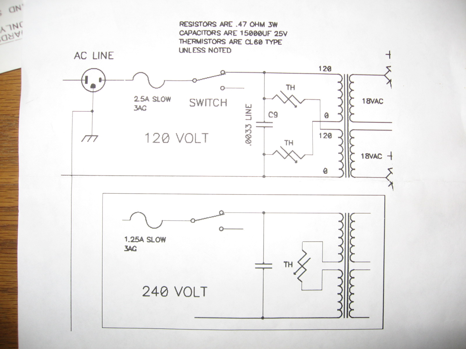

Yes, but that can be done without thermistor.
So yes you are right, but the reason a thermistor is used and not just a direct wire connection is to stop audible earth loops with interconnected equipment.
So the complete answer is: A thermistor is used to meet the requirement of "all exposed conductive parts must be connected to Safety Earth". The added benefit of using a thermistor (and not directly connected) is to minimise audible earth loops.
The thermistors on the primary (mains) side of the transformer are to reduce inrush current as Renron stated.
Hopefully this clears everything up.
Thanks for the replies, including from the Master. I do not have twin windings on my Toroid transformer at the primary. It is just one winding for 220v. How do I connect up the Thermistor? Also the way it is shown in the PS schematic, the entire primary current flows through the thermistor isn't it? Am I not getting something here?
Cheers.
You can have a single CL60 thermistor on the live line, it will be enough for your purposes. A 110V connection requires two as the primary current will double.
The thermistor limits inrush current. During steady operation it remains in low resistance mode, as the current at switch-on is pretty high it warms up and its resistance rises (these are PTC, unlike the ones in the amplifier circuit), limiting current through the primary.
Yes, it is is always in the mains path. If that is something you don't like, you can make a small soft-start circuit with a resistor and a relay, and a small handful of parts.
And welcome here, good to see you again 🙂
I could have sworn I've seen more amps with PTC protection on the primary, but you're right, the CL60 is NTC. I dug up some older posts by Andrew where he explains the logic of using NTC rather than PTC, I guess you could do it both ways.
The datasheet for CL-60 also shows that you will probably need two CL60 in parallel for 220V as their current capacity drops with voltage, like a solid state device.
Thanks Sangram. Nice to catch up with you again though on a different forum.
I have NTC types. I will double the Thermistors for taking more current.
Cheers.
still wrong.
220/240Vac needs at least 0ne CL60 in the primary feed.
If you choose to use two CL60 then they must be in series.
Think of it as being the same as the 110/120Vac situation each primary has it's own CL60.

I have used soft-start earlier with a mains-rated relay and a resistor, works fine for me. I was more interested from a future reference point of view, as the CL-60 indicates lower load capacity (cap bank) for higher mains voltage in datasheet. I assume this means that two CL60 can be used in series for higher mains voltage with same cap bank?
