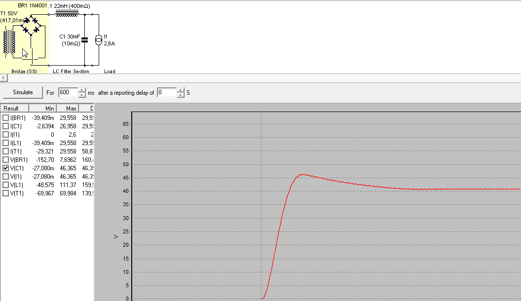

Duncan's Amp Pages , download PSU Designer , and you'll know , after some play with proggie

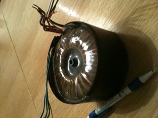

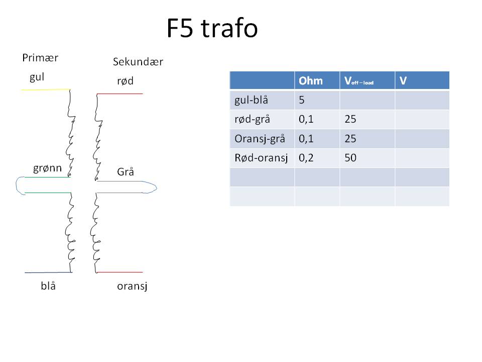

Here`s what I worked on: By ohm-ing the primary and secondaries of the tranny I used the button in PSUD2 where you can enter ohm-values for trannies. Then I made a filter in PSUD2 simulating including a couple of filter-chokes that I have. The chokes are 22mH/200mOhm/7Amax. Now, in PSUD2 you cannot make a +/- supply so I did it like in the picture. At 2,6A load the current thru the choke is 4A. I have tested my chokes and they do not buzz until 7A in a powersupply like this.
Well, I get +\- 20V output if I do it like this. Do you think it is suitable for an F5 project?

Those two are impossible to match - manufacturer never meant them to be a complementary pair. They are very different... The beauty of F5 design is that they don't need to be matched at all - that's why we have those two 5k trimm-pots.
Sorry, to be clear, I didn't mean matching the Ps to the Ns, but more I meant channel matching, ie the left P to the right P and the left N to the right N.
the output voltage of a choke input filter is very dependant on the current drawn through it.
Change the 2.6A to 5.2A for maximum draw on one polarity of the PSU (5.2A into 4ohm).
Then change the 2.6A down in steps of ~0.5A, down to 0.1A.
How does the output voltage vary over that range of output currents from 100mA to 5200mA?

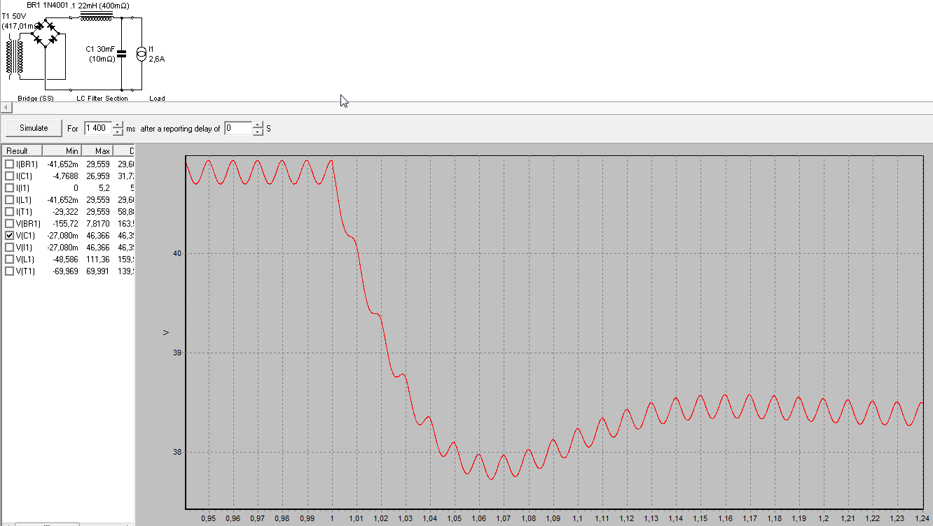

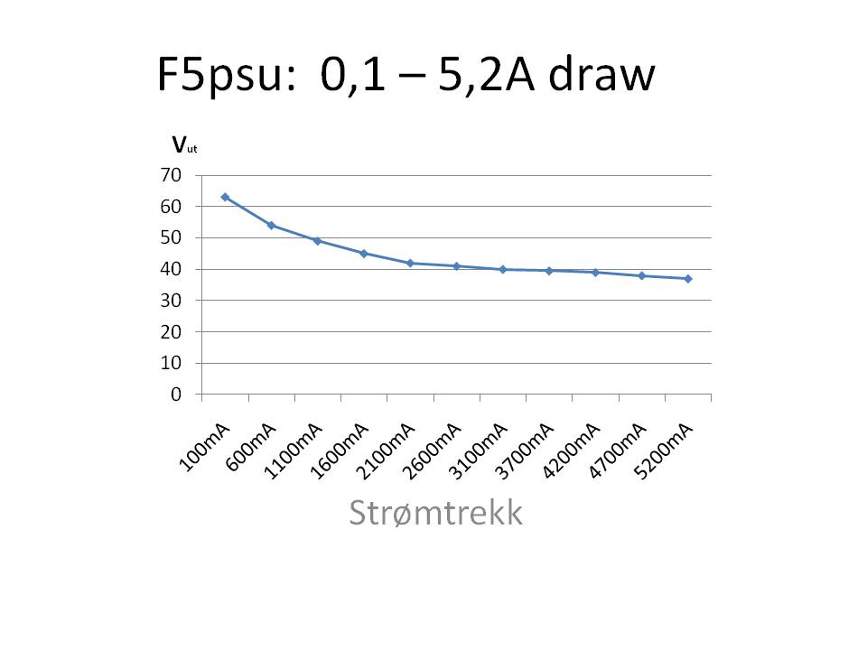

I did the excercise in PSUD2 and plotted the Vout values in a graf.
I also did a current step sim in PSUD2 jumping from 2,6A to 5,2A current draw. I`m not sure how to interpret the data though.
If the F5 amp is biased to 2,6A (both channels), will the amp still vary the current draw from the supply from 0,1A to 5,2A. I thought that was more like class AB behavior.

That looks typical of a choke input filter.
the voltage holds well over the current range from 2A to 5A.
But as the current demand falls below 2A the voltage presented to the amplifier rises to eventually reach 1.4 * Vac (offload), whereas the on load voltage is ~0.9 * Vac(on load).
the range of current that a choke input filter can supply and hold close regulation on the voltage is quite narrow.
As the current demand falls the required Inductance rises.
Double your choke Henries and plot out that 100mA to 5200mA graph.
ClassA amplifiers modulate the supply rail current just like all other ClassAB and ClassB, except ClassA does it gently with few harmonics. ClassAB and ClassB do it quite abruptly and generate lots of HF harmonics.
