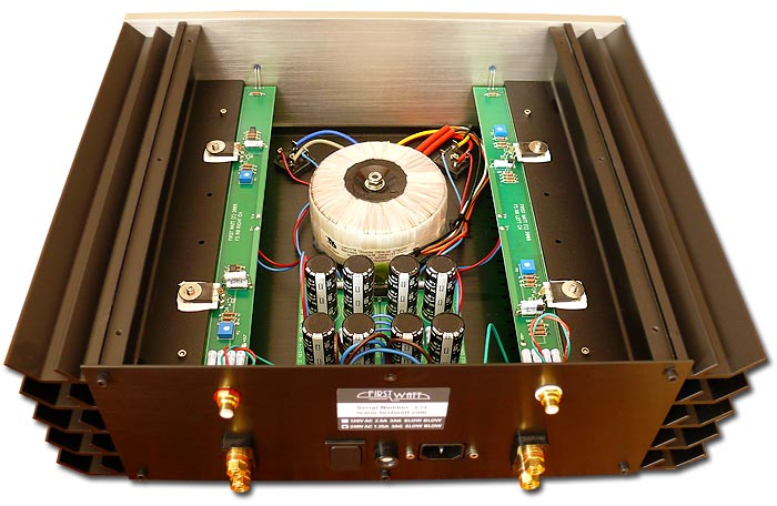

Papa also uses clips. A spring loaded clip is likely to move with the heating and cooling but maintain a more constant pressure over time. A torqued screw attachment may eventually squeeze out the goo, or even the pad, under hgh temp, then relax to less than the pre torqued pressure when things go back to normal 😱
:Pawprint:
:Pawprint:
Ummm.
Looks like Papa uses the same as most of us; washer and lock nuts (aircraft nuts).
Ron
:Pawprint:
Agreed, however, the screws should be retorqued, and the bias checked and reset, after a few temperature cycles anyway.
