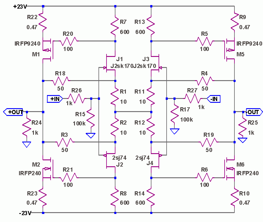

My PRP resistors arrived from the States Thursday evening.
After a few hours of soldering, setting bias, running the normal square wave and frequency response tests, etc., I have been listening to one channel for a few hours now.
Quite listenable. A touch on the bright side, but surprisingly tight bass. Source for the quick test was headphone output from Micromega Stage 1, via battery powered DRV134 for balance conversion. Loudspeaker was B&W CDM1 with (DIY) Mundorf Crossover.
Circuit is similar to the balanced version posted by Tino.
Rails are +/- 16V, total bias 4A.
JFETs are matched 2SK170BL/2SJ74BL running at 5mA.
Output MOSFETS are 2SK1530/2SJ201.
Source resistor 0R22 & 0R18 respectively.

The heatkins is 400x160x83mm.
U = 15V, Bias = 2A (4A total)
Maximum temperature heatkins - 48...50 degrees (room is 26 degrees)
Transformer - 2x13V/800W
MUR 3060
CRC : 2x47000-0,15R-2x47000

2X13V? isn't the supply of the Vac should be around 16+/- to get a +/-23Vdc?
can u explain more in this? i just need to learn more. 😀
50watt@8ohm for class A is awesome!
Your build is following exactly on this?
He built according to a circuit EUVL talked about a while back. Its a different voltage than original F5. Less voltage = Less heat. Then its biased up a lot which probably brings it back to the same amount of heat lost in original F5, or close.

To get 2A bias voltage must be smaller - 15 ...16V.
The maximum I run parts like this is 50W each, assuming
that there's lots of heat sinking. This means that at +/- 21V
rails, you could try for 2.5 amp bias.
