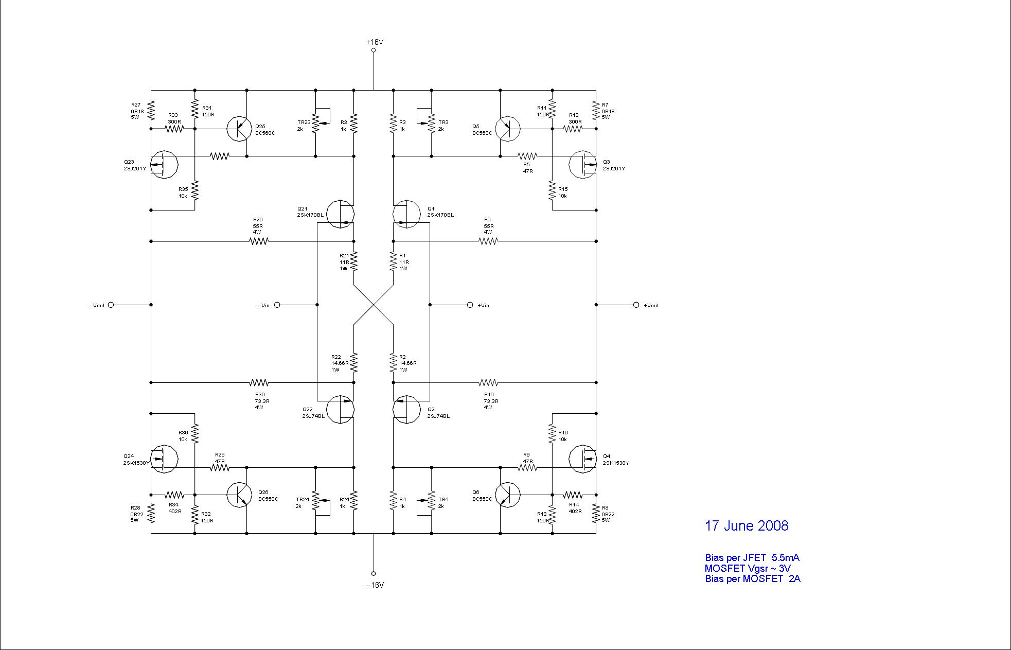

I saw a couple of posts up a balanced f5 - unless I'm mistaken, i believe the one posted by Patrick (EUVL) which the OP ref with the tosh fets is this one ... haven't really seen much written up on this (well not in one place), so perhaps someone who knows much more abt the amp can give some comments re supplies, power o/p, grounding and what degradation (?) occurs if you use same resistors in both top and bottom halves... best that I can recall from reading the archives, they're unequal due to diff transconductance between the P n C channel devices, but wonder how much of this is, well, academic...

balanced or bridged
as one speaker terminal voltage goes up the other goes down.
The voltage between the two speaker terminals is double what would appear between one speaker terminal and ground.
If the load impedance is the same the current will try to double.
Double the power into double the impedance.
NOT
quadruple the power into the same impedance.
NOT
Is there a disadvantage of balanced or bridged?
NOT
Hmm, i had always thought bridging would give you 4 times the power ...
