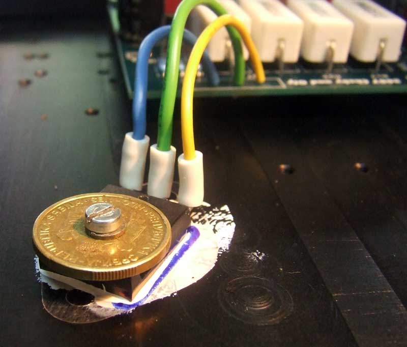

you MUST use fender washer , but - beside fender washer - I'm using lock washer to ensure constant pressure - even if I'm mostly using mica & goo
funny - I found that old ( non valid , but also even valid :rofl: ) coins are best for purpose .... almost as they are last pieces from personal stash of Baron Krupp ...... :clown:

What are those white insulators on the joints to the mosfet?
