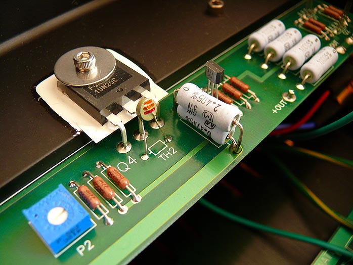

isolate leads of thermistor , and lean it to mosfet case
Yes, you shall not glue them to the MOSFETs. Besides the fact that the glue
probably will melt (and smell funny) the thermistors would react to fast this way. Attached is a photo from an original F5.
BTW the photo shows something interesting, Nelson has chosen to use a lower source resistor value for the n-channel mosfet (0.47 paralell to 2.4 = 0.39)
attaching the thermistor to the drain leg of the FET is one of the fastest ways to monitor temperature changes at the FET junction.
Is the FET Drain and the thermistor touching, or a gap, or glued?
Yes it is the fastest way but too fast I believe. I´ve read that people who attached the thermistors directly to the MOSFETs experienced some "overreacting" of
the thermistors, resulting in a bias that goes up and down. From what I see on the photos there is approximatly 3mm air between thermistor and mosfet allowing the thermistor to slowly counteract when temperature rises until a thermal equilibrium is achieved.

Your claim that the thermistor is too fast does not seem right to me. Maybe it is applying too much correction.
Creating that gap reduces the level of correction. It might be better to get that intimate contact and reduce the thermistor sensitivity by for example adding a series resistor to the temp comp. There are probably other ways to make the servo effect stable, but reducing the effectiveness of the temperature monitoring does not seem a good way to me with my lack of knowledge.

FWIW when I had the thermistors touching the FETs it took me a really long time to stabilise the bias. I would set it, and ten minutes later would have to dial it back a notch. Ten minutes later I had to dial the other one back a notch. Before I knew it I missed the sweet spot, and I'd have to do it all over again.
I run without thermistors now, and it gets to temperature a little slowly (~2 hours) but once there the bias and offset are rock-solid. I have to readjust every few weeks because of changing ambient temperatures as we approach summer, which the thermistors might have helped me avoid. No free lunch I guess.

"does not seem a good way" - well it has one clear advantage: it works. (This is probably why Nelson has chosen to do it that way).
