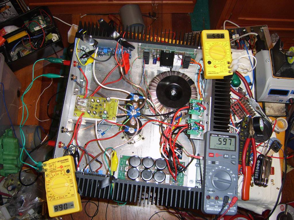

Hi All,

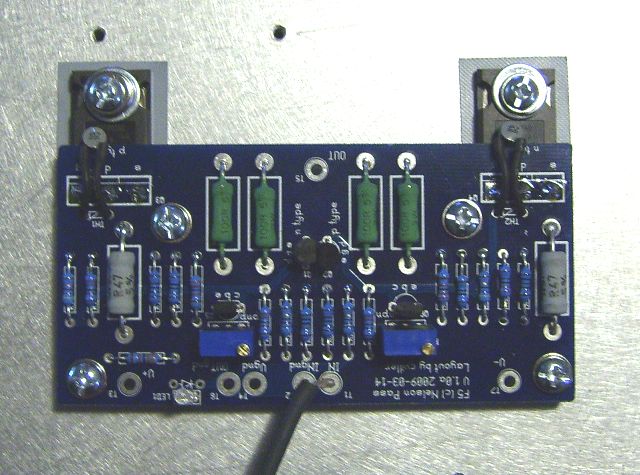

Recently I had a Le Monstre amp for sale.. it sold but the frieght was too expensive to send overseas >20kgs. so i decided to try the F5 modules i purchased from Cviller in the case... adjusted the supply to +/- 20V biased the amps...
I have to say the cviller boards are really well made. and the amp was easy to set up nice and stable....
Anyhow I have been listening to it for a couple of hours so far it is a really nice sounding amp credit to Mr Pass with this one !!!
couple of pics attached
-Dan
