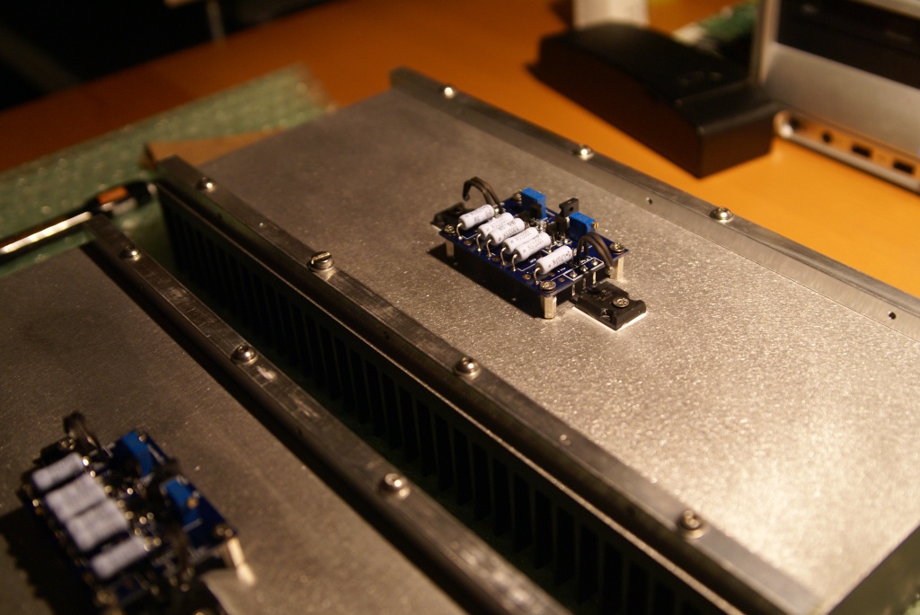

you already have isolated leads of thermistors ; just push them to mosfet case , maybe even with blob of thermal goo in between
if you want - use RTV silicone or any other sort of silicone like glue , but be careful - to not mess direct contact of NTC with mosfet case

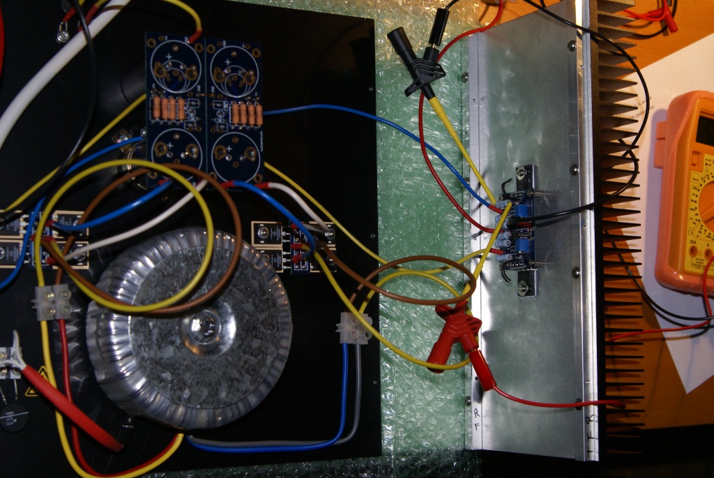

so, i'm 99% sure my trimpot is shot...when i measure P2 from pin 2 to 3 I get 72 ohms (min) vs the other pot (P1) I get .3 ohms
The other channel I get .3 ohms for P1 and .4 ohms for P2
I had one of my pots installed backwards at first, so i had to desolder it, flip it, and resolder it, and I can't tell which one it was, So I'm putting 2 and 2 and assuming I damaged something inside the trimpot.
