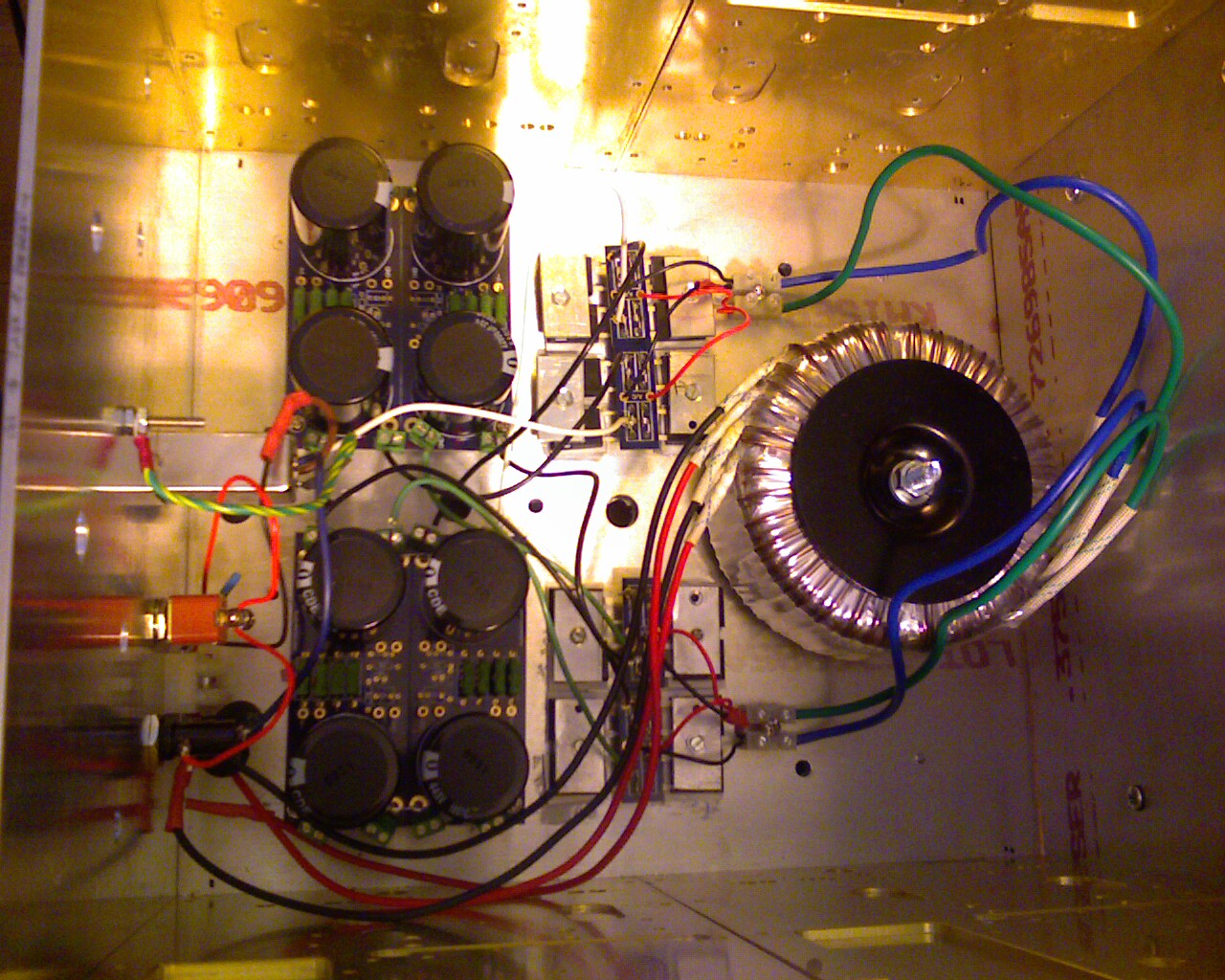

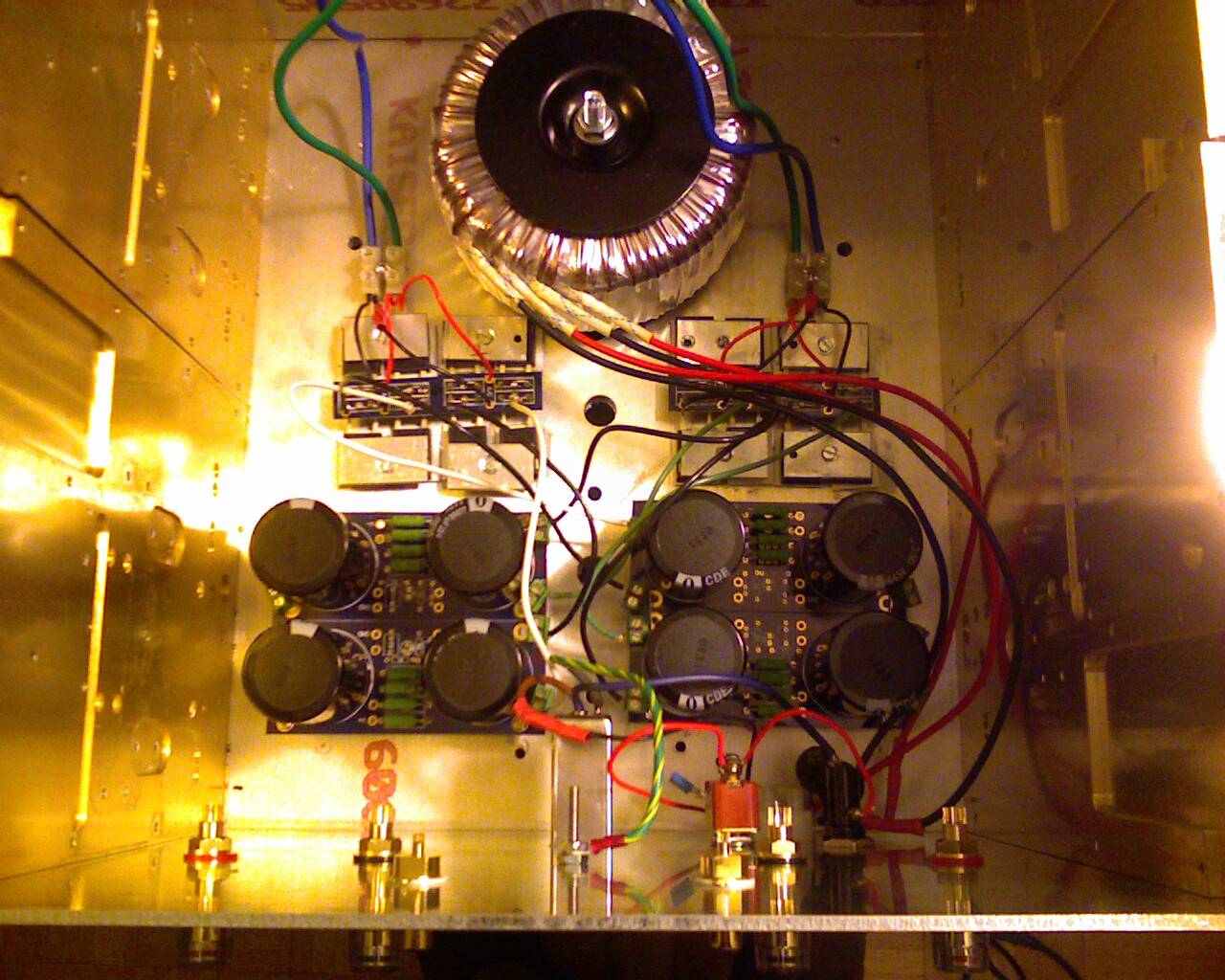

Another F5 in the books!
My second F5. Only one transformer this time. Used Hexfreds and Caddocks.
No thermal or protection circuit. Sounds great!

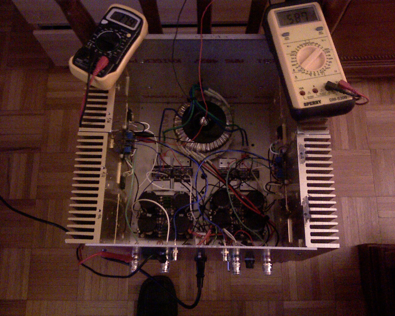

Trouble with biasing one channel
Try as I might the only way I can get dc offset on one of the channels to acceptable levels is at about 0.35v on the output resistors. The other channel is fine and to spec. I did hook up the mosfets wrong on the problem channel at first and had some smoke and fumes, but I replaced all the 3w resistors including the feedback ones which I thought I saw the overheating and fumes coming from. The music plays fine at this lower bias and the output levels are comparable to the other channel. In fact imaging and balance are precise.
The two questions I have are -
What other part could've been damaged causing the biasing issue? In real terms does having a lower bias simply mean that I'll hear the poverbial 'klunk' a little earlier on that channel? Especially if I cannot hear a perceptible difference in sound quality.
You'll have to give us other voltage readings (measure where Vdc are indicated on the F5 schematic) for us to have a better idea of what's going on. Check your input fets for shorted D-S --a 0Vdc reading indicates a short. Check for output Vdc offset value.
What about the pots? Did you check them before putting them in? With the amp off, and power removed from the amp board if possible, measure across R3 and R4 (2.2k) while adjusting the pots for each side of the PCB. You should get around 1.5k max. I think the pots should be at zero before applying power again.
Found that because the leads were short on the Bourns pots and usig large gauge solder, I had a cold solder. One side of the PCB was not registering any resistance when adjusting the pot.
I think the issue is with one of the pots. I see little variation in voltage when turning it. I had used bourns multi-turn ones because I thought it would provide finer control but they really are very inconvenient to use. Let me replace them all with single-turn types and see if I can resolve this.
btw I checked the voltages across the various components and they compare well with the good channel except for the output resistors and offset. Also the transistors checked out fine.
It's alive !!!
It's alive !!! It's alive !!! And this time it's not a monster 🙂

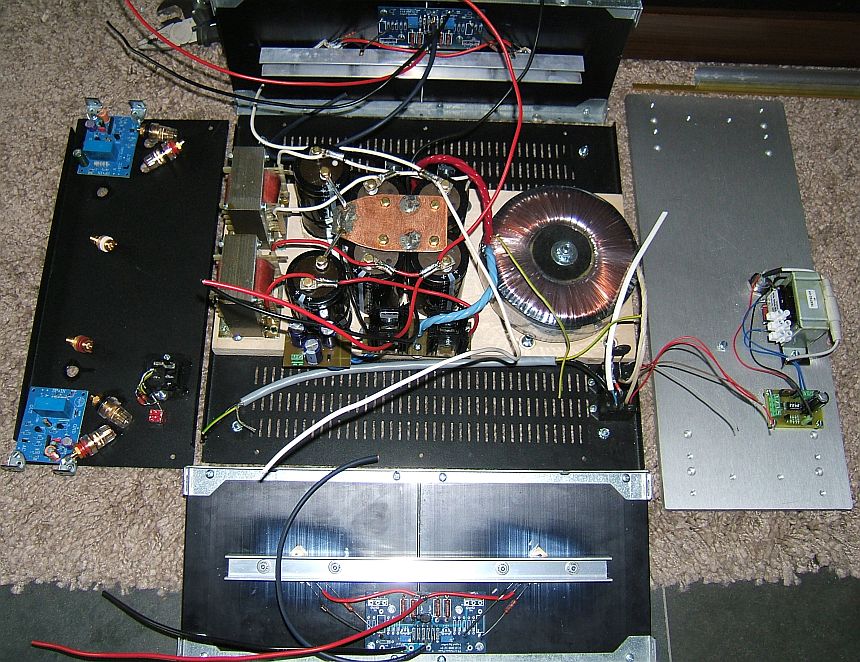

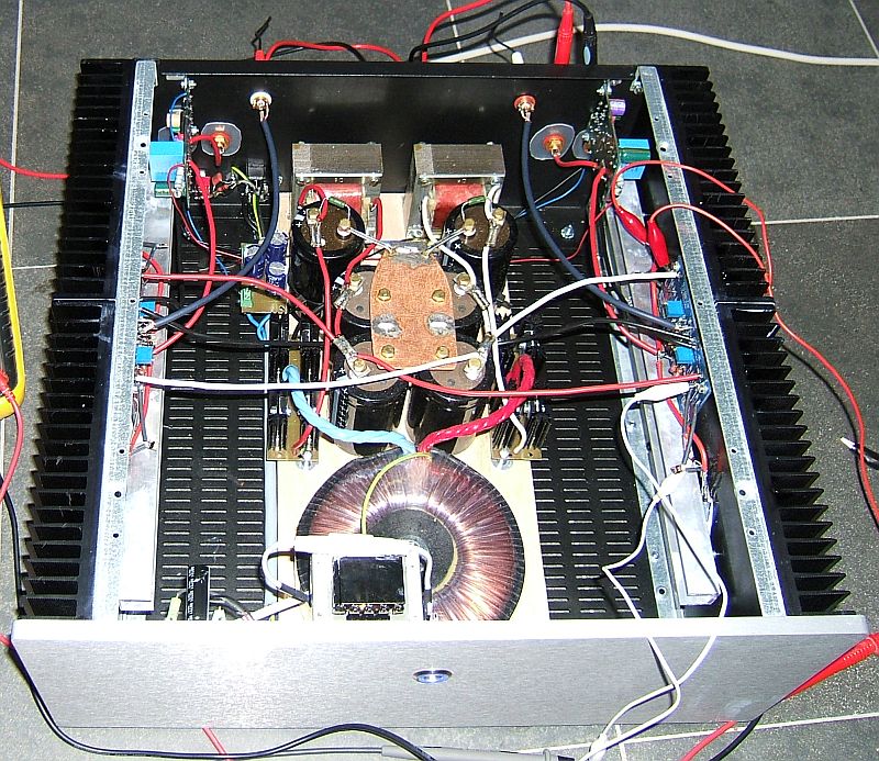

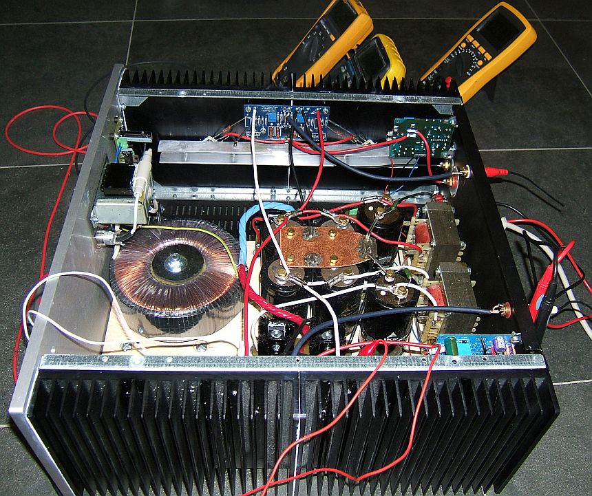

Finally I have finished my F5 built, after following this thread for a long time and collecting parts it's now playing and it sounds very very good.
What's inside:
- 500VA Toroidy transformer MUR3020 for the bridge
- CLC power supply: 47000uf -> 10mH chokes -> 2x22000uF sikorels
- F5 simplified circuit without temperature tracking, current limiting and with reduced feedback (2x150ohm) à la Peter Daniël.
Fairchild transistors, Mills MRA5, Takman REY and TX2575 z-foil resistors.
- circuit ground connected to mains earth trough a loop breaker circuit, case of course connected to mains earth.
- soft start based on CL60 and circuit from Sylvain Bergeron.
The soft start has its own small transformer and power supply, the switch on the front panel activates the soft start:
a double relay is switched on that puts the mains on the 500VA transformer with a thermistor CL60 in series,
after two seconds that thermistor is bypassed with a second relay, so that the mains is directly connected to the 500VA.
I's nice to hear the sound of the relays clicking 🙂
- DC protection based on upc1237: basic circuit like in the datasheet. DC protection, time delay at power on and AC level detection.
For the upc1237 and the 24vdc relays I needed a higher voltage than my rail voltage(24vdc),
so I added a voltage doubler (the 4X8) that gives me 48vdc.
loudspeaker relays are the LRZ from amplimo: first a contact that can switch 100A (at 50V) is closed, after that the contact is bridged by a gold plated silver contact.
I'm very satisfied with this amplifier, my other reference is a two stage DIY KT88 PushPull with interstage transformer as phase splitter,
compared to the KT88 gives the F5 better detail but a little less bas. The F5 gives me more the feeling of being there, I like the F5 more 🙂
Thank you Nelson for such a nice amplifier !
Danny
