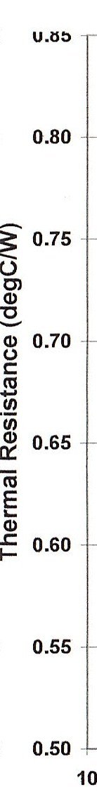

I've been looking at heatsinks and I was wondering about using this one... well two of them in each monoblock. Can anyone tell me based on the information provided if these look plausible to use? I don't know anything about thermal dynamics... but many here seem to. They are used for high output led lighting, which I know gets very hot too. They are almost 3 inches thick and about 6 inches around.
eddie
The last graph already shows the thermal resistance of the heatsink.
(thermal dynamics 101 : the thermal resistance number depends on the temperature difference between heatsink and ambient. The higher the temp difference, the higher the efficiency of the sink)
Theoretically they look very plausible.
The outer ring consists of 36 ribs of 30mm length, 36 times 30mm times 75mm heatsink height makes 810 sq cm.
Times two sides makes 1620 sq cm cooling area, or ~250 sq-inch.
Comparative example : an SK53 heatsink of 100mm height roughly has a total air exposed surface of 1150 sq cm, aka ~180 sq-inch.
An SK53 of 100mm height does a thermal resistance factor of ~0.70 C/W.
Practical problem for the power-LED heatsink is how to attach the power device to the inner ring, preferably in a thermal efficient way.
My first random cranial hickup would be to ram a round solid aluminum bar through the peep hole, and screw the power transistor on the solid core.

I was wondering how would be best to mount to this sink. Nice idea! Now he has to get the right size round bar but thats nice solution.
2.25" diameter by the looks of the drawing, standard size.
Throw the heatsink in the kitchen oven at a few hundred C and the bar in the fridge for an hour.
Then slide the bar in the heatsink and Dick's your uncle.

The center section is solid... there is no hole in the heat sink... how does this affect the exposure calc?
