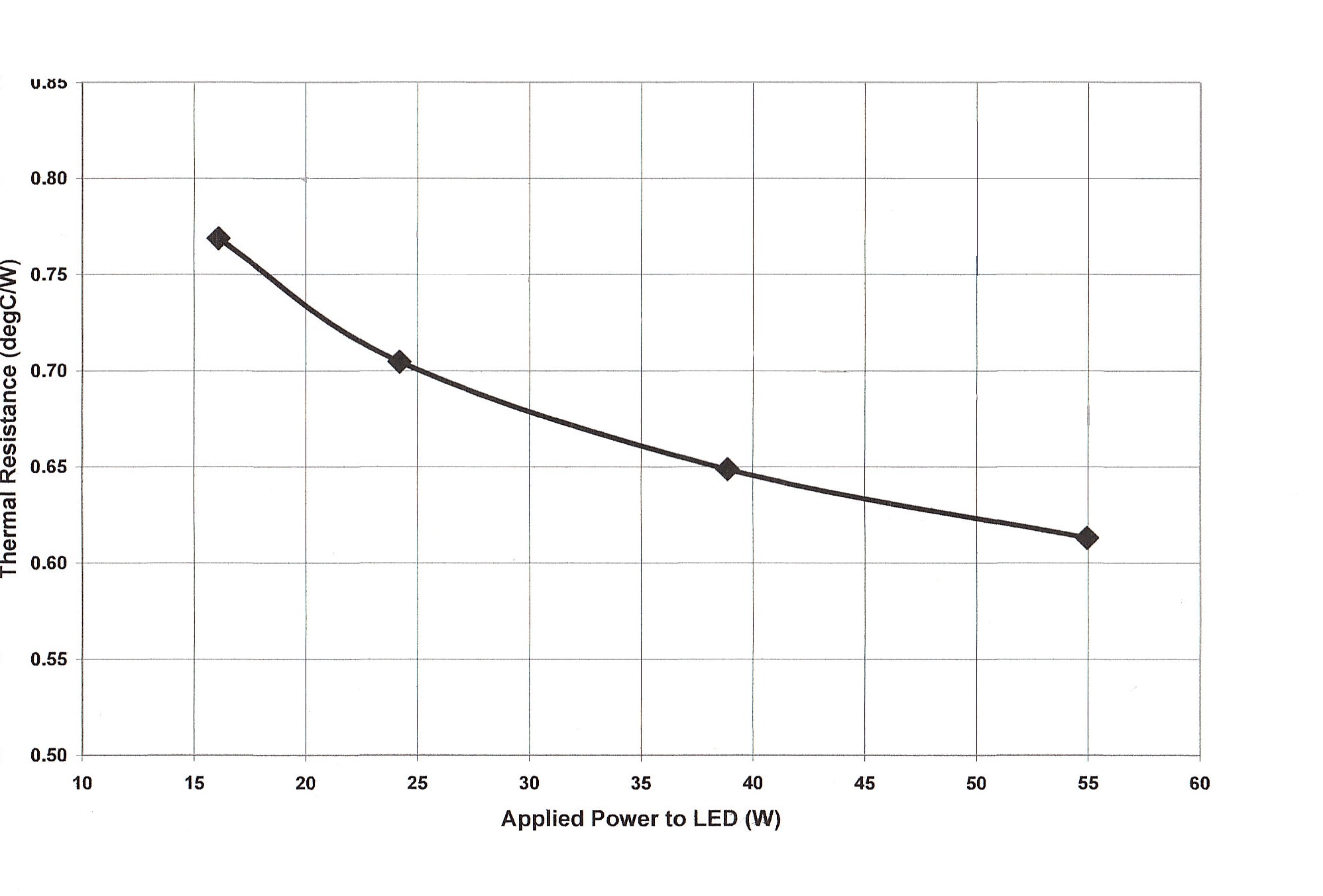

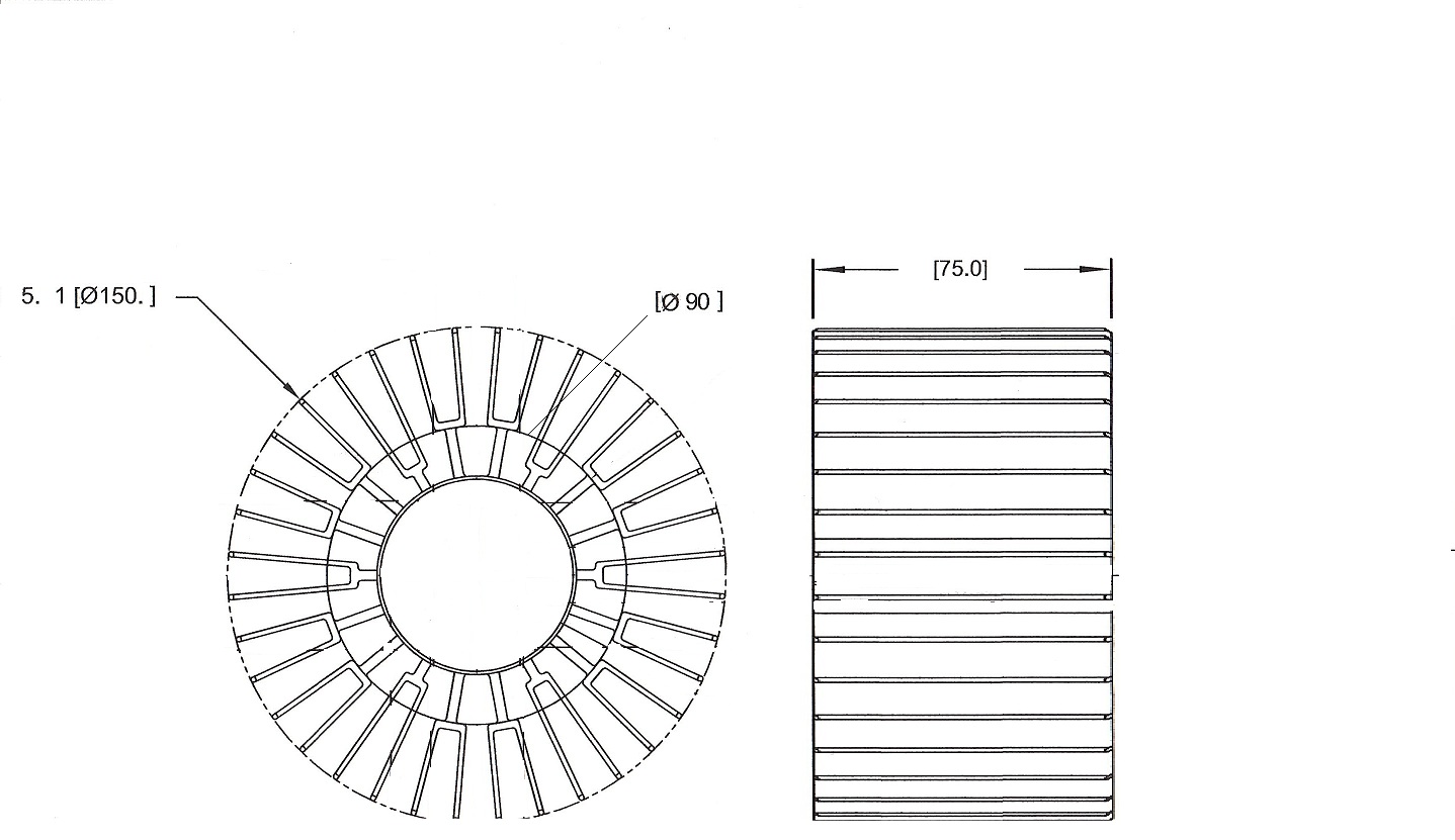

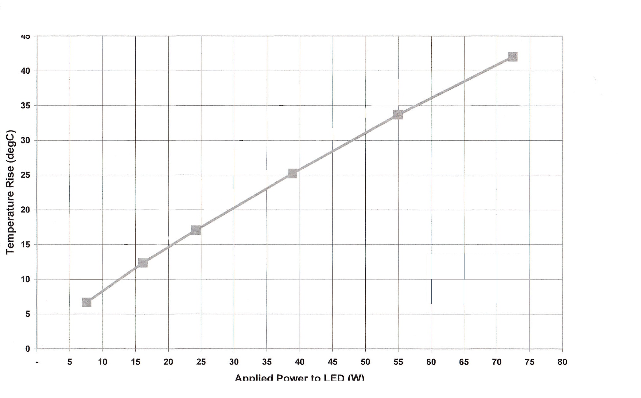

Possible heatsink for F5 ???
I've been looking at heatsinks and I was wondering about using this one... well two of them in each monoblock. Can anyone tell me based on the information provided if these look plausible to use? I don't know anything about thermal dynamics... but many here seem to. They are used for high output led lighting, which I know gets very hot too. They are almost 3 inches thick and about 6 inches around.

If you have many of them, and fore free, mayb, if you find a proper way to mount devices with good heat transfer
But dont think I would actually buy them
Inner surface to transfer heat to periferical finning is smaller, but if its good or not I dont know
And height of 3" is only half of whats usually considered minimum fore this
In a world of no miracles I dont think its effective enough
But it might be nice fore classAB
Or maybe with fan cooling

The fellow with the round PC processor heatsinks - those are designed to be blown with a fan (noise) at a very high CFM, assuming that is what they are... otherwise they are not likely to be able to get rid of enough heat.
EDIT - oh, wait they are for LED lighting - find out the relatively efficiency of the LED, watts of light OUT vs HEAT, that will tell you if these will do the job. The graph shows watts of LED... although there is no spec on the heatsink, IF these graphs apply to this heatsink this idea will work - but I think the graphs merely show the spec for the heatsink that is required for a given LED wattage.
