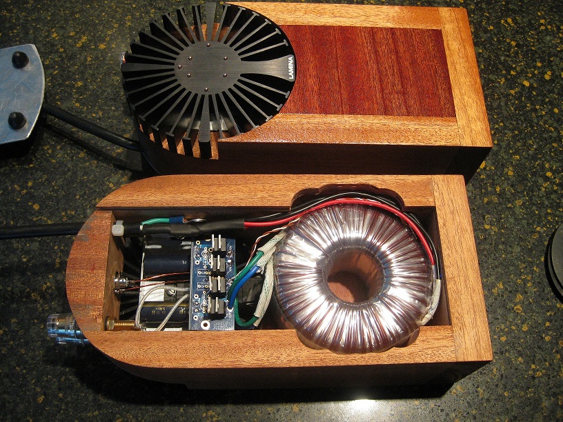

Or, It could look somthing like this... one of Peter Daniels gainclone kits I made using one of the other heat sinks this company makes.

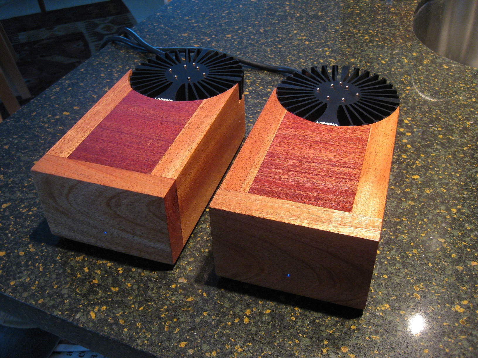

Very very nice erpiii! Although I must say to let the hsink sit atop if you use it for class a as the wood reduces the hsink's effective area.
The amp in the top of the picture is right side up... the amp at the bottom of the picture shows thew underside of the amp with the bottom removed.
This is how they look in use.

I once experienced amp module burst into flames, literally
And it was a famous proven design, but known to be occationally unstable
I wont mention any names
Fortunetely I smelled it, and nothing happened
I use wood too
But its a good question if we really should be using wood at all
Sorry if it appears negative
Such things never happens, but you never know
Just a word of caution
