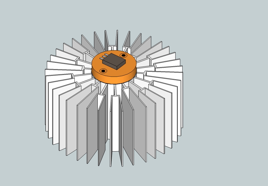

Thought about using a copper plate 3/8" thick to spread the heat evenly onto the heat sink I have been investigating... Uriah... you hear anything yet from Florida?
I still doubt that these are going to handle the heat... maybe 2x the height... maybe...
I'd guess that unless you can make the two surfaces dead flat that ur better off just going direct to the bottom of the center slug. The other problem with a small bit of copper there is that there is a different coefficient of expansion and it may want to act like a bimetallic element, and lift off the surface...
Another problem with this heatsink is that for it to work properly it needs to be very "free air" all the way around. That means if you mount the device as shown, and near the PCboard, there will not be a way for free air flow to occur.
I'd want it free of other surfaces by something greater than 2" maybe 3" or better...

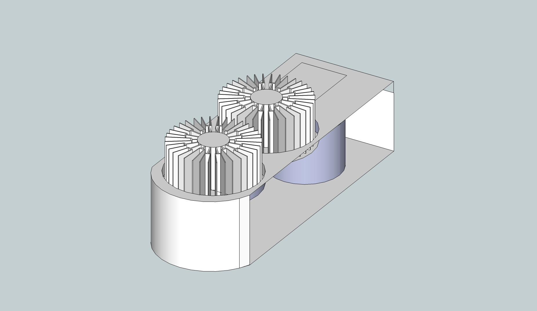

How about somthing like this then... It would be difficult to join together two high.
Cool drawings! What was the reason for using these heatsinks? Was it only availability or do you have some cool plan for the whole chassis?
I think you could potentially make some extremely nice looking amps with those, but in the end, I'm sure it will be much more expensive that ordering some sinks from eg HeatsinkUSA, llc
Do you have a drawing of the complete chassis idea?

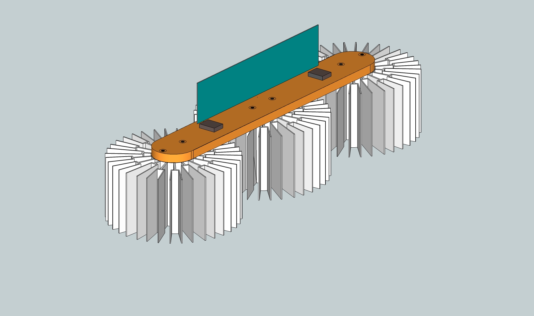

Well I was thinking along the lines of something like this... maybe with three instead of two... I dunno... all I do know is I'll be using the boards I got from you! Thanks for the extra mosfet spacing! These would be two mono blocks.
erpii, I think you will need to blow air if you enclose the fins like that.
For natural convection one needs to maximize the airflow, otherwise you have to derate the heatsinks by quite a bit - which means the amp will get too hot, which means the thermistors will cut back the bias, which means it won't be in full class A anymore...

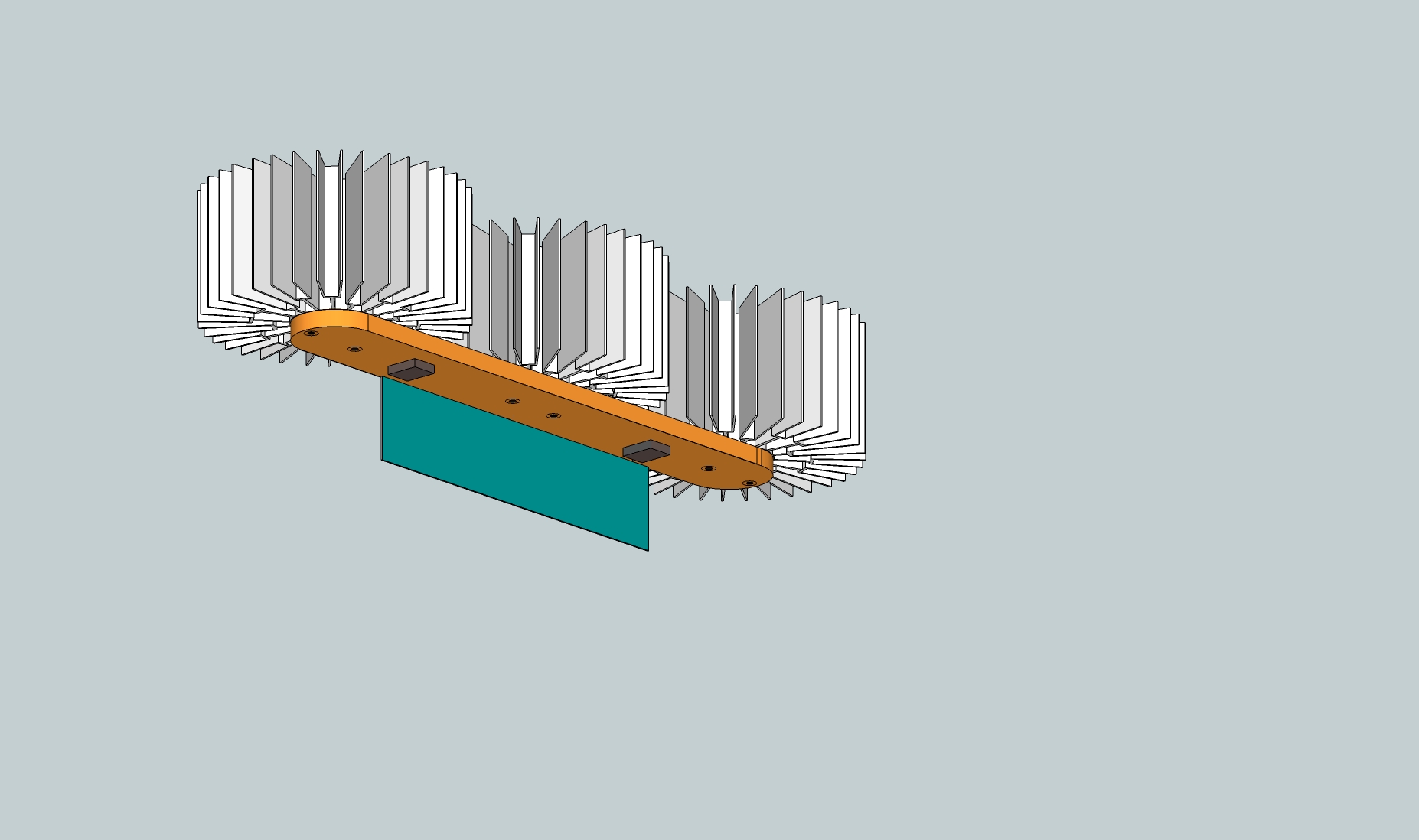

...and I think one might consider putting the board into an "H" configuration... let me try ascii:
O O
| | <---heat spreader "bars"
------ <---pcb
O O <--round heatsinks (not to scale)
EDIT: when I post the spaces get chucked and the drawing squishes left justified - use your imagination??
You could use 3 per line also... and the distance between the heatsinks is only because of ascii drawing...
I dunno...
_-_-bear
I wish I had info to share but they have not got back to me yet. However I have to agree with bear. Airflow may be necessary. I dont think it will need much though. Even a breeze will help A LOT. Computer fans are getting very very quiet. I recently got one for about 4 bucks to waft away solder fumes. Running it on a battery and a pot. I cant hear it at all even two foot from it. I would put them below pointing up. I think it would do it because I think those sinks are less than you need but not far from what you need.
Uriah
Uriah
Agree ! My intention is to run fans also ....
My LR is dead quiet.
I am in the country.
60Hz. transformer hum can seem deafening late at night especially in the winter when there are no bugs to make outside noises.
Fans are problematic. At least have the fan operation controlled by a thermistor for speed control or worst case a thermal switch or two with either resistor or control of the set pin of a 3 pin vreg so that it is quiet until it gets hot...
The quietest fans are "squirrel cage" blowers. You'd want one that is oversized and then run it way below it's intended speed, like crawling around.
I am considering doing just this via something like a clock motor or other very quiet low RPM motor and run the blower via a rubber "O ring" belt for decoupling ... not much breeze is a lot more cooling than natural convection...
