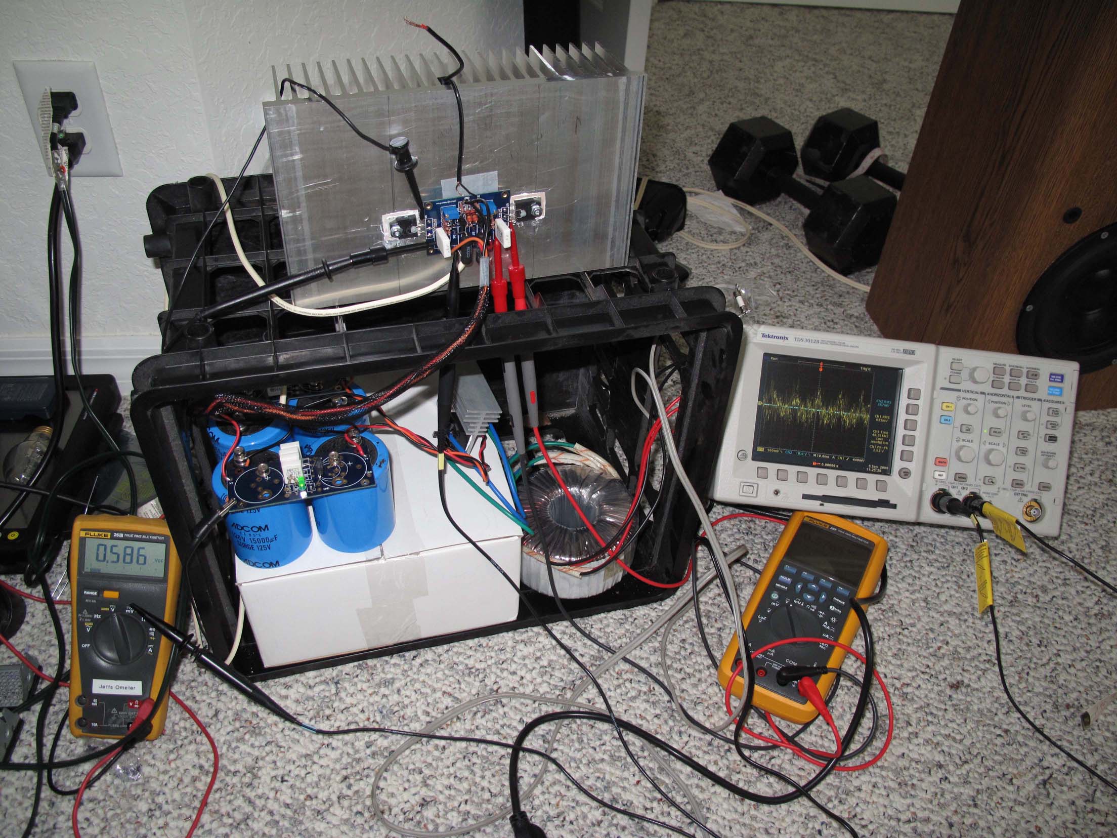

Here's a pic of my first functional channel. It has since evolved into a chassis and grew a brother.

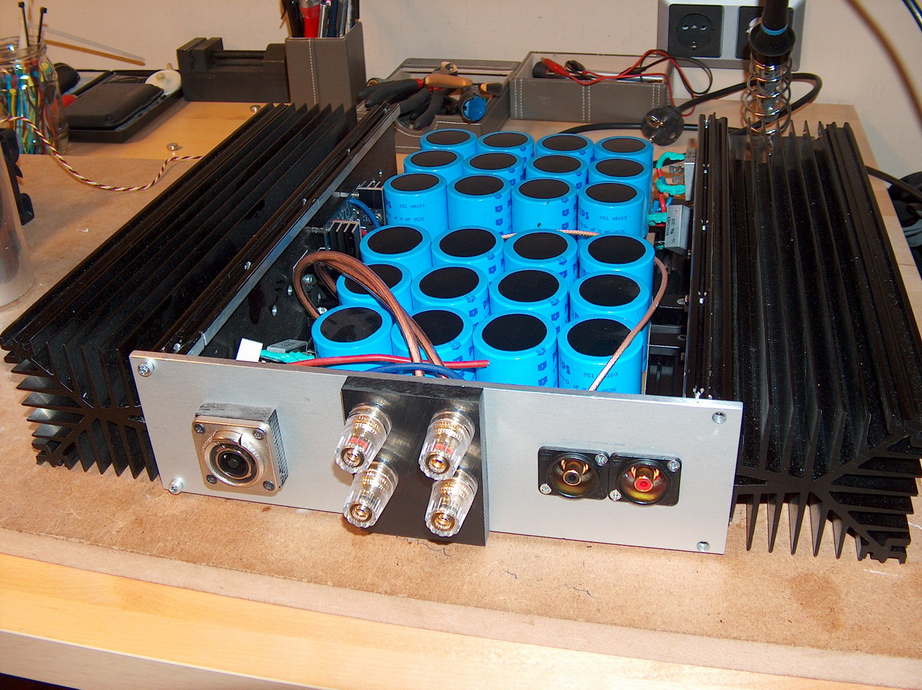

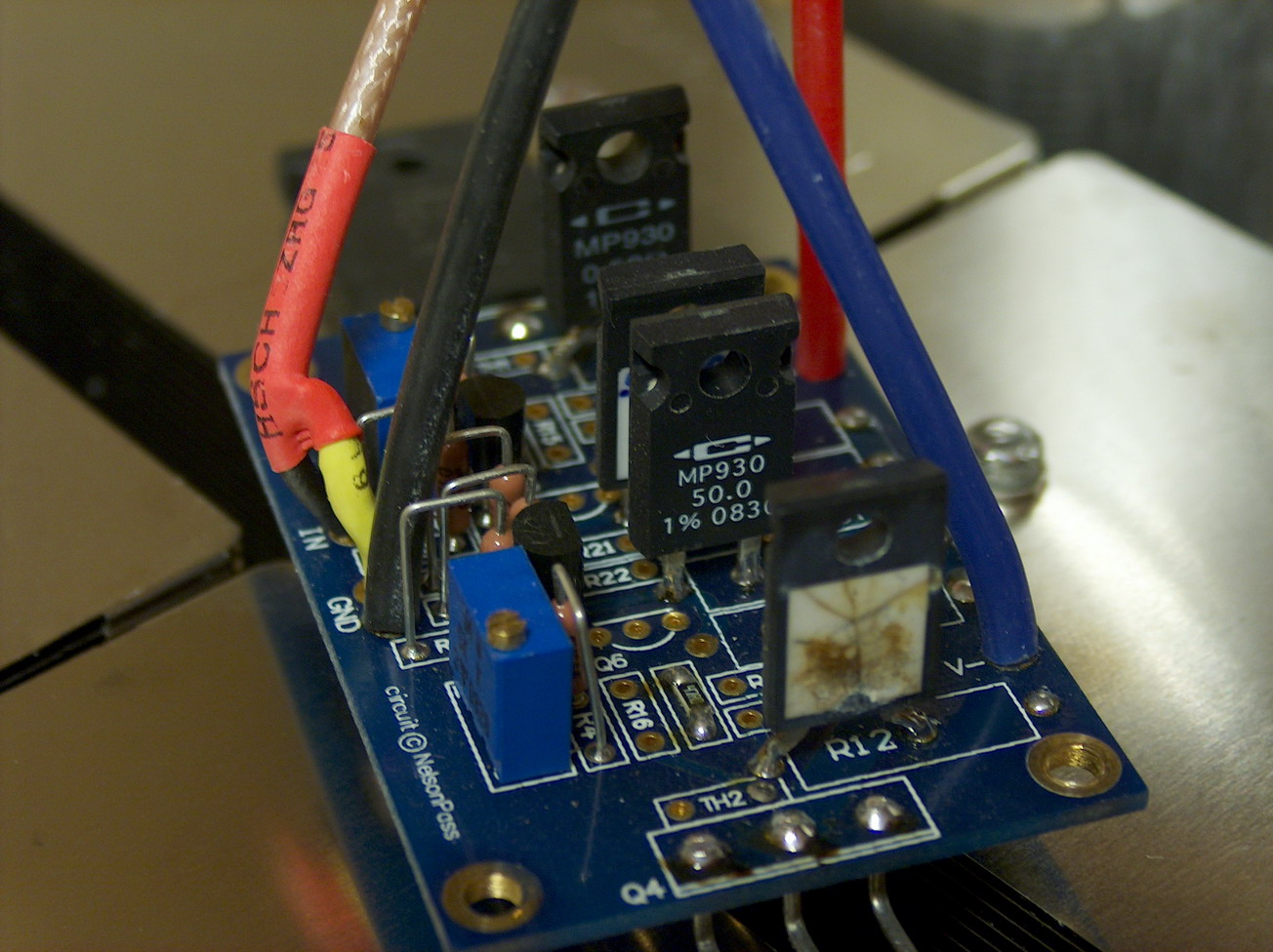

You are far ahead, the brother of my F5 is still under construction, because after the last update I did some mistake and reversed the PSU polarity at one channel... It´s really a pain to let the smoke out of caddock resistors :rolleyes:

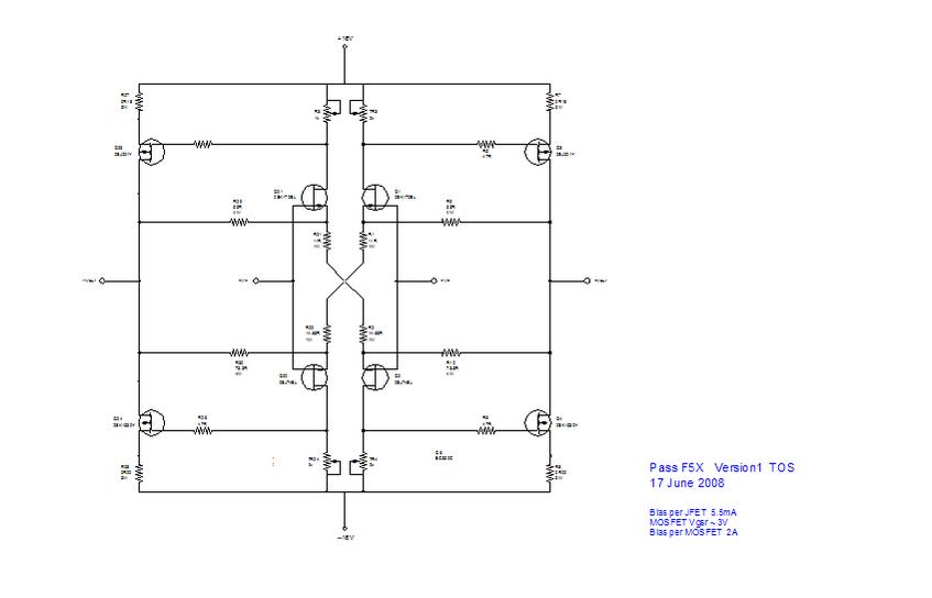

I would like to ask some (help) opinion about a high power F5X with out cascode using multiple power mosfet.
It is possible to use 3pair power mosfet / channel powered from 24V rail power supp. based on the the attached schematic ?
I like these simple schematic (unfortunately it is hard to read any value of the components) any way probably with 24V rail would need adjust most of the resistor values .
In case someone interested for a high power F5X please let me know .
We could make some plan together ,I do not have the skill to modify the schematic to a high power verizon .
I have 14PC 2SK1528 & 18PC 2SJ200 matched Toshiba mosfet , JETs , a 20-0-20VAC 1.5KVA Plitron toroid & monster heat sink (enclosure) over 25lb.
I would like to use these to build a F5X instead a high power F5 .
The (enclosure) heat sink was design for a Aleph2 but I like the X topology better. I have a Aleph X , I like the sound of the X so much , it would be great a high power F5X .
Thank for any advise or help .

If you do the x version you won't really need 3 pairs on each half (2 pairs per half will do), unless of course you want to bias greater than 6A (3A per half).
It is very straight forward to do.
Go for it
Tell us what bias and rail voltage you are intending on using.
The only thing that might be a bit tricky could possbly be adjusting dc offset
