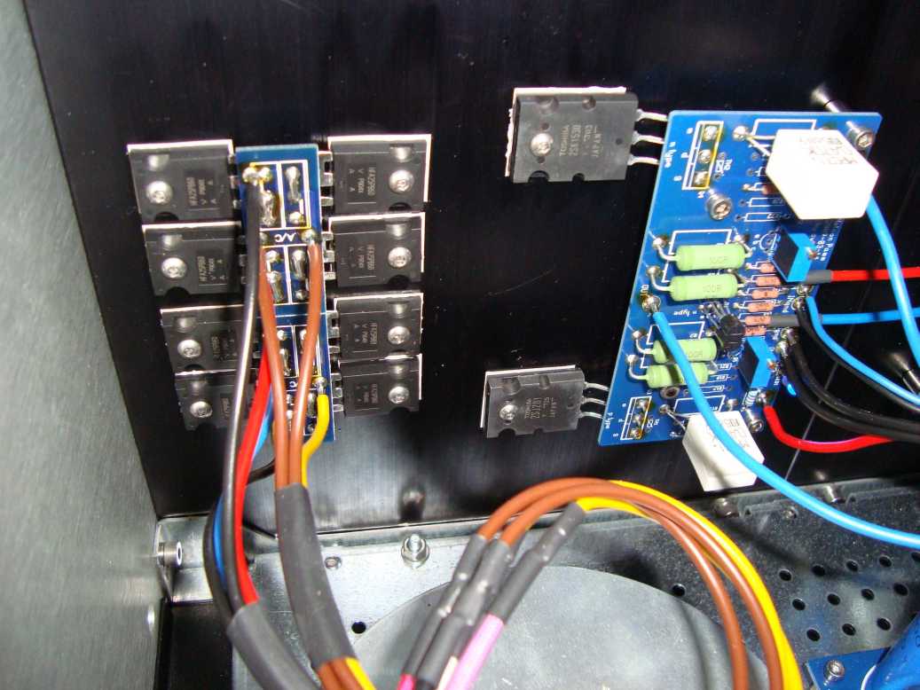

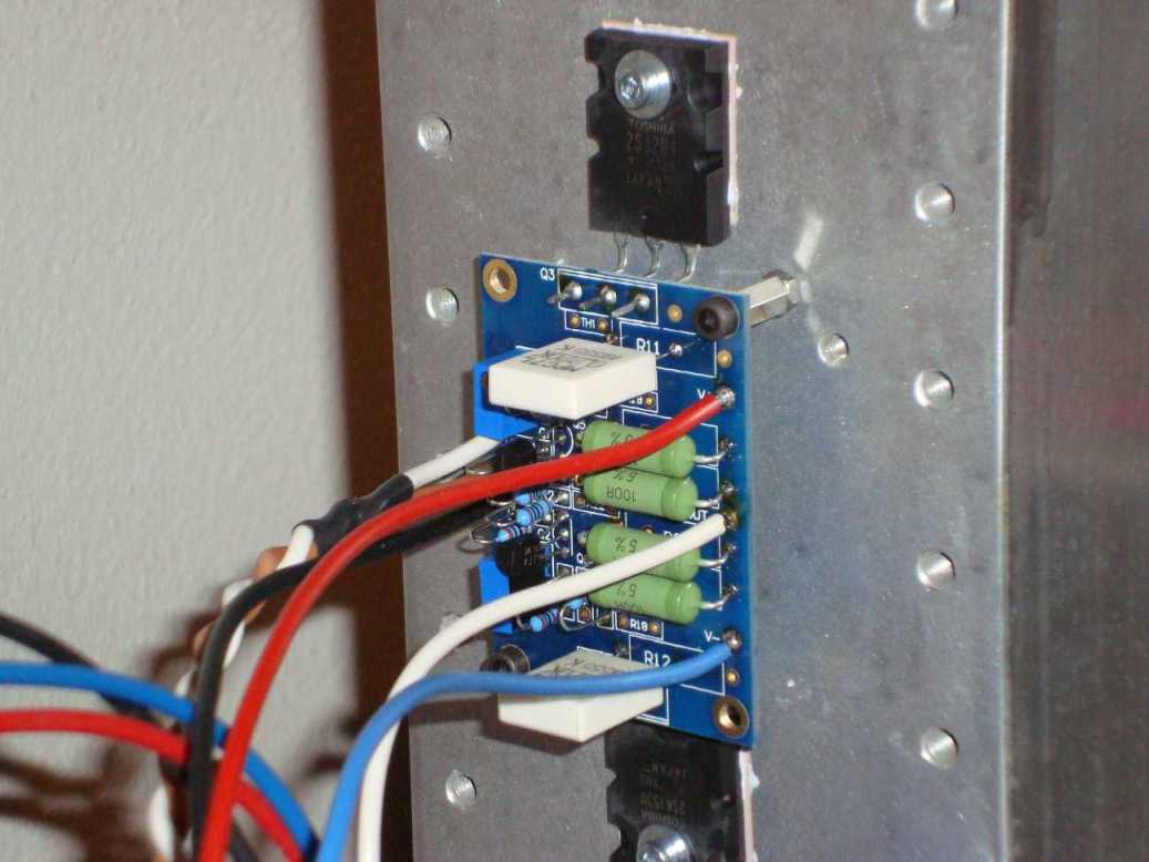

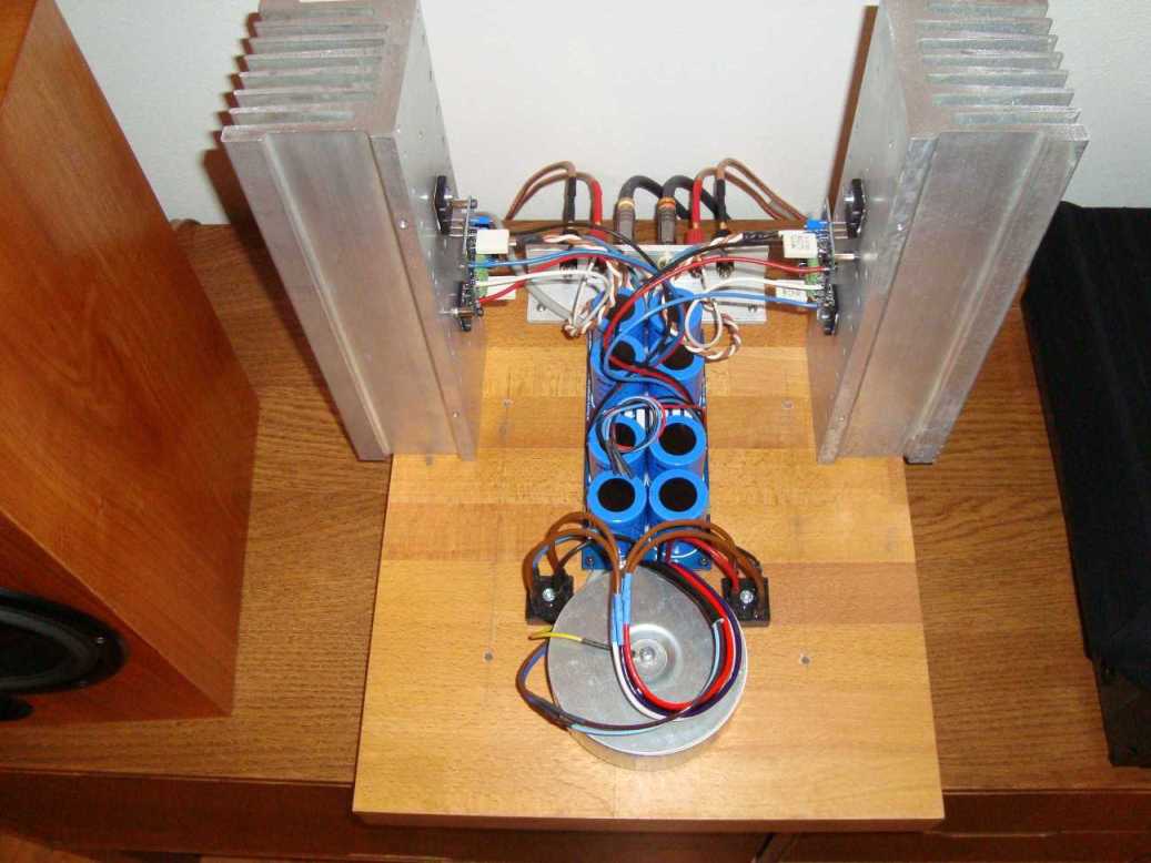

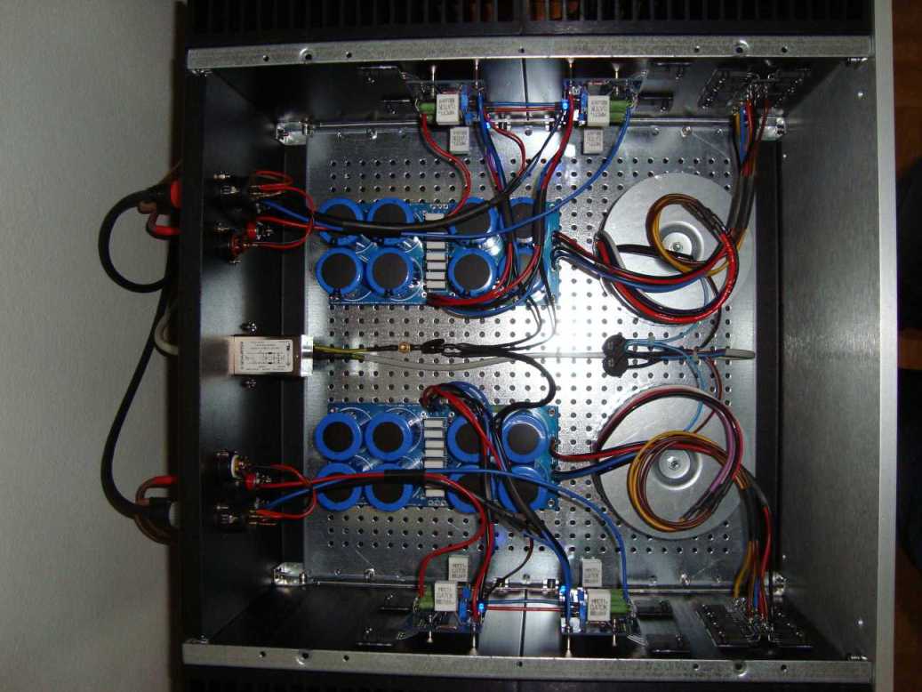

my F5 adventures
after listening for around 4 month or so to this wunderful amp I think it's time to post some technical details and of course some pictures.
My actual F5 is based on EUVL's balanced F5 posted here:
http://www.diyaudio.com/forums/1542055-post1216.html
But I didn't implement the output protection circuits (Q4, Q5 in the original schematic) and used identical values for the source resistors (R1,2 =10Ohm, R11,12 = 0.235Ohm) and the feedback resistors (R5,6,7,8 = 100Ohm). The output devices are 2SK1530/2SJ201 from Toshiba.
The bias current is set to 1.6A. Unfortunately, the rail voltages differs between the right and left channel (left: 2x12Vac -> +/-14Vdc, right: 2x15Vac -> +/-18Vdc) and the toroids are a bit small for such an class A amp, they are rated only at 250VA. I've ordered new ones rated at 400VA.
It's built up with cviller's boards for the amp channels and power supplies, and boards from Peter Daniel for the rectifier bridges. The enclousure is from Hifi2000 (Pesante Dissipante 05/400).
Here are some pictures:

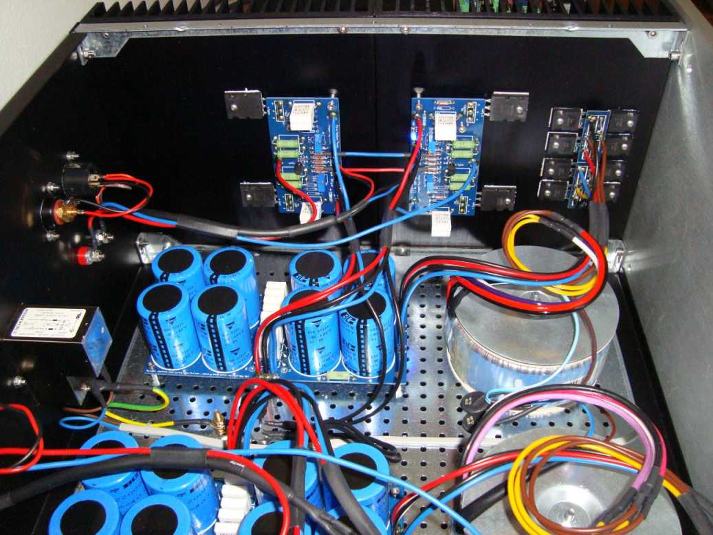

my F5 adventures (cont.)
Before building my actual balanced F5 I set up an original one, it was something like an "engineering sample" and useful to play around with bias current, supply voltages, etc.
For this version I used the boards from Peter Daniel because they fitted better to the heatsinks I had.
Again some some pictures:
