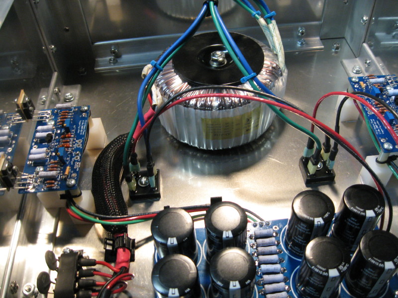

Finishing up on the F5 build and thought some might like to see the efforts. The fact that a Caveman like myself can build one of these and have it sounding good and looking fairly decent speaks volumes about the ease of construction and the elegance of the design.
Big thanks to Nelson Pass for releasing the design and allowing some of us into the world of Class A.
The chassis is a DIY, all aluminum construction. The heatsinks are from M&M metals. I'm still working on the faceplate. It will be polished just like the backplate and sinks. I just can't stop listening to start on polishing, again 😀.

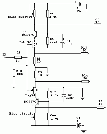

boyz
maybe - before throwing any amount of money or energy in it - is wise to re-read Papa's pdf few more times ?
just one thermistor per rail ; it's temperature sensitive input jfet's drain resistor , nothing else .
go back in thread and look for several already made F5s with laterals in output
if I remember - jackinnj made at least pair of them
