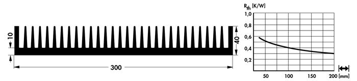

I have TWO heatsinks, each measure 300 wide and 400 long(high), with thick base
They should give plenty cooling, tho I dont know excact cooling specs
I still regret having cut 100mm off each of them
QUESTION?
If I cut each of them in half, so that I have 4x 300x200
That way I can have 2 heatsinks pr mono
Would that give more effective cooling, over using ONE sink twice as big pr mono
I know this is more of a luxury problem, and may sound pretty daft

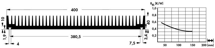

btw, only reason I was looking at Fissher SK157 is that it has long 80mm finning, and very effective
But I certainly wont pay 600 EUR to 1meter raw heatsink
US heatsinks on Ebay? Its heavy and shipping is a problem
dammit, I had promissed myself I would lay off this kind of hysteria
take a wild guess =>
Ofcourse
That heatsink might actually very well be the exact one I have
Fore that one 200mm is the optimal limit where cooling gain curve flattens, and cooling gain becomes less beyond this length
Which indicates that 2x 200mm is more effective than 1x 400
Now thats settled, I can spend some money on other more important parts instead
Close to 100% more effective.
SK56 is the most common 300mm heatsink in these parts.
The curve of the Seifert KL-146 shows even better that it levels out at 200mm height, the KL-146 is close to identical to the Fisher SK56 that i posted earlier.

a 100mm high sink can dissipate X watts.
A 200mm high sink can dissipate ~1.4*X watts.
A 400mm high heatsink can dissipate ~2X watts.
A 800mm high heatsink can dissipate <<~2.8*X watts.
A group of four 100mm high heatsinks in a row or forming four sides of a square chassis can dissipate 4X watts.
An 800mm heatsink cut into 8off 98mm high lengths to form two monoblock chassis can dissipate ~8X watts.
Assuming the back plate is thick enough and that deltaT(s-a) is the same for each.

That very nice info on relation between various lengths, and good to know, really good explanations
But bare in mind that its simplified to understand the relations
Note that almost all different heatsink designs behave different with various lengths
Ofcourse the number of outputs used, relative to sink size, and how they are spread/mounted have to matter as well
Fisher site is comprehensive and good to study to get some understanding of the effectivenes of various heatsink designs
Roughly, the longest finning seems better, and expencive
Also very wide heatsinks appears to be good, but of little use with only 1 pair output
Unless you do it like the master do it
I have no doubt that when 2 smaller heatsinks fore each channel is suggested in F5 manual, its well knowing that they are easier to get, and maybe cheaper as well
And makes nice small monoamps
