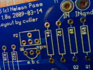

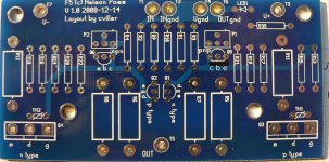

This was my understanding, also, regarding the trim pots, until I fired the amp for the first time. I am using C Villers boards and the Bourns 5K trimpots. If the trimmers are turned counter-clockwise, full current will be delivered to the circuit. The trimmers must be turned clockwise to zero the current You can read the gory details Here. Fortunately, my components survived this misstep and the amp is settling in well.
I have measured the bourn pots and as used with cvillers boards, I get 5k (maxed out) between pin 1 and 2. Thats turned CLOCKWISE btw.
Now I am doubting which is the correct way to turn em. Any thoughts?
Not that I doubt your experience Westend, but just wanne make sure that I install these correctly.

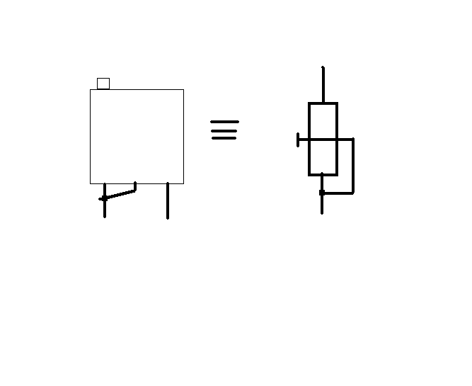

trimpots in F5 are used as adjustable resistors - that's acomplished tying middle pin with one of outer pins ; so - that's two pole thingy
it doesnt matter with left or right one .... actual positioning in physical domain will give you decrease of resistance clockwise or anticlockwise .
for proper adjusting - one need to use brain , instead of putting parts as pieces of puzzle .
use that DMM ; prior powering up that amp , be sure that trimpots soldered in circuit are adjusted to short between pins

Russelc, clip your ohm meter across R3 and turn the pot screw and see which way the resistance goes. Keep turning the screw toward the direction that lowers the resistance until the resistance quits dropping. Do the same with the meter across R4. This will be your setting for the initial power up.
George

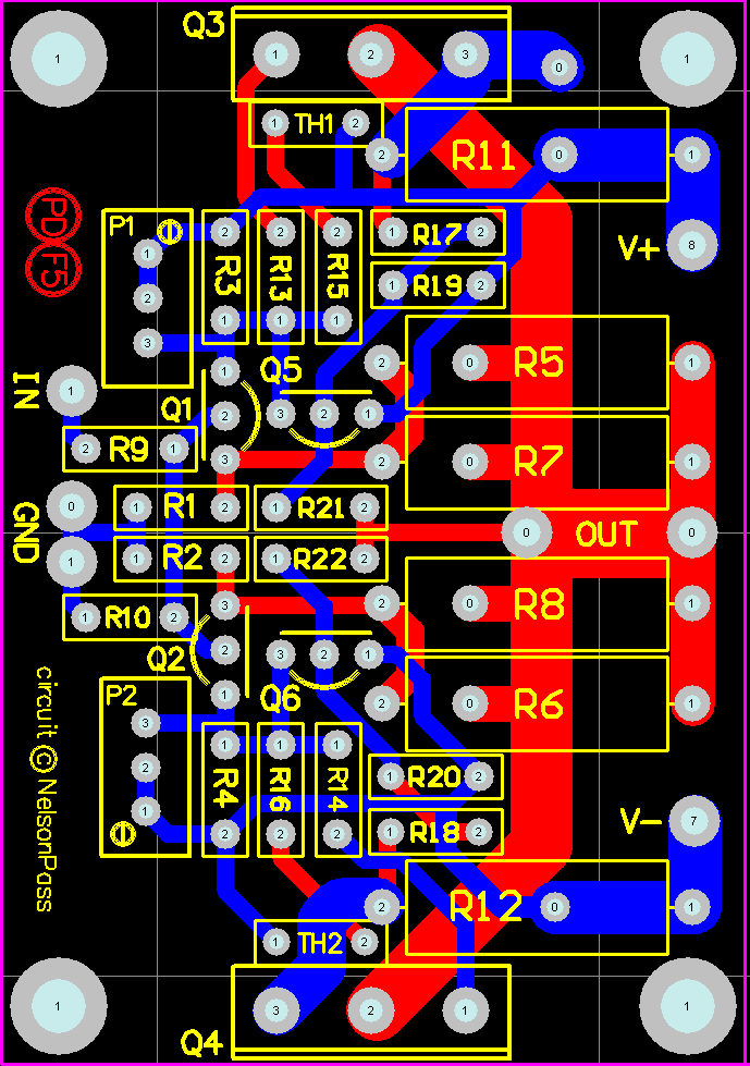

Looking at the picture of Cviller's board for P2 I can see that if you use the 3266W (offset legs) then it will short/tie together the wiper (pin2) with pin 1. In this case, to start with zero ohms you will indeed have to turn it completely clockwise to start and bias by turning counter-clockwise. I built my first F5 with Cviller's board, but apparently used an in-line style and oriented it with pins 2&3 together, so that was why I remembered starting with it completely counter-clockwise and biasing it by turning clockwise. I should have been more careful with my advise. :(
On Peter Daniel's board he has a little symbol on the board for the screw so that you will orient it with pins 1&2 tied together, so you will zero it by having it turned completely clockwise.
I'm very sorry about that. Hopefully no one has melted their amp.

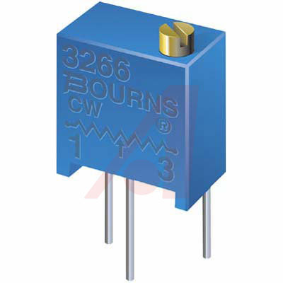

I get home and I look inside my first F5 with Cviller's board and see that it is a W style trimpot, so I'm thinking "what the fudge?" :confused:It was made with a tech-diy kit and the website lists a bourns 3266W.
I look inside my parts bin and see that I have an extra one. I notice that unlike the picture I pulled off the internet, this one shows the pins labeled the otherway! :headbash: Perhaps one is a counterfeit or mistaken art?
Just to confirm, zero ohms achieved in the completely counter-clockwise position.
