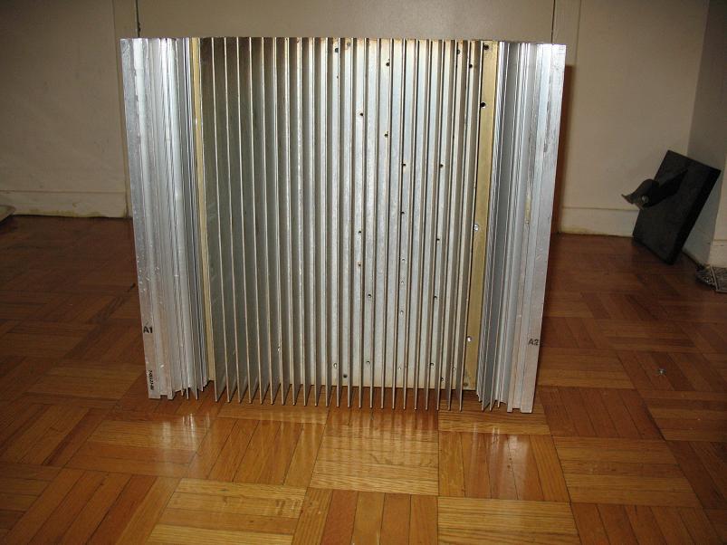

For the normal F5X I do not have transformers (I want to use what I have at home if is possible), also around 24V rail i read the power mosfet tend to sound better . I don't know if these true about the Toshiba devise or just IRPF type . It would be a waste use such a large heat (25Kg not 25Lb , I wrote a mistake in another post about the size of the heat sink) it was design to a Aleph2 for the simple F5X .These not because I will need 100W monster POWER . I'm interested to get a great amp not a big monster . The only reason I want to use what I have at hand already . A great Plitron transformer like mine 1.5KVA 250bucks . If the higher power F5X not possible, unfortunately I will have to go with the higher power F5 but I'd like the X topology .
One more time everything I have at home to go with higher power verizon if these would be possible !
So why not to use all the parts I have already?
If is possible high power F5X I will post some pic. from the material I have . Now I charge my battery for my camera .
Greets

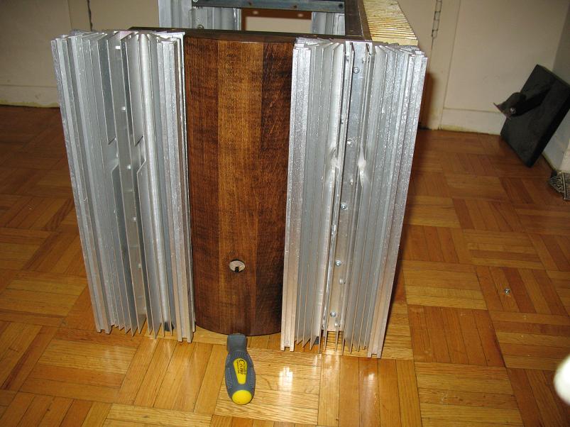

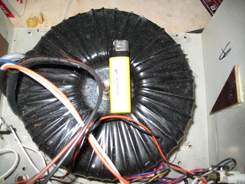

I just want to post some picture from those parts I have at hand .
The heat sink 15" tall .I think that can handle even 100W power . Over 25 kg the enclosure with out any parts .The transformer 1.5KVA from Plitron it would give 24V after rectification (I use it in my Aleph X with 7A/ channel .
I have the matched Toshiba mosfet enough to build even a 100W amplifier .

Patrick picked 16Vdc rails because that's 12Vac rectified.
Maybe first we should agree that when referring to 24V rails we would expect it to be 24Vdc, from 18V trafo
24V trafo should give you 33V rails
I suppose thats what you mean
Impressive collection you have
Just a small remark of caution
Those expencive mosfets may be highly sensitive to statics
And to place them on a highly static plaid like you show in your post, that might not be the best to do
I dont know so much about that issue, but that I would avoid
