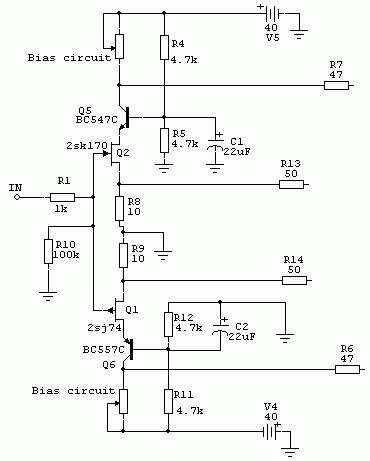

gaborbela,
2SK1529 & 2SJ200 are great output devices for F5 - using them is an improvement.
Your schematic with 2sk135/2sj50 (2SK1058/2SJ162) as cascodes to input JFETs is a waste of good parts - cascode devices make no contribution of their own, you'll be fine with some nice BJTs, like BC550/BC560 or similar.
The other thing is that your idea won't work as drawn in you sch.- 2sk135/2sj50 (2SK1058/2SJ162) lateral MOSFETs are Enhanced mode devices, they are not self biased like JFETs.
This is a possible way to cascode input JFETs:

Hello Juma
First of all thanks for your help !
I want to be clear do the laterals work how the schematic was drawn & simulated by thanh1973 or not ?
These is not a question about the (value of laterals) , I just want to be sure when I put the amp together it will work 100% !!!
I already design the PC board layout with the 2SK1058 & 2SJ162 Hitachi laterals after how the schematic was drawn by thanh1973 .
Now I will wait , I do not each the PC board until these cascode mode is not clear totally!
I also have Hitachi 2SK214 & 2SJ77 driver (lateral) , if those are OK I can use them . I prefer laterals for cascoding if there is any advantage ,I like the soft sound of the lateral mosfet . I do have 5-6pair at hand .

No you don't have to use bipolars.
Since you already have the laterals I would use them.
Maybe try it point to point first just to confirm if it will or won't work, the way it is drawn in the schematic.
Juma could be right, that it won't work the way it has been drawn. However the simulations say otherwise.
Do one channel point to point and if it doesn't work we will make the necessary changes to get it to work.
With 40 Volt rails you have around 300mW to 400mW going through the cascode device.
If I had some lateral mosfets I would do it for you.
For cascode I use 2SK1058 & 2SJ162 orig Hitachi
why such a high power FET for the cascode?
the cascode device passes the jFET current and drops ~half Vsupply(+0.6Vbe-Vgs of output). The dissipation ~100mW to 150mW, for 5 to 7mA of jFET bias.

I'm sorry but now I get confused ...
We have here following issues:
- word "Lateral" (as in "Lateral MOSFET") describes construction type associated with negative temp. coef., but it's stil enhancement mode device (meaning that k135 needs gate more positively polarized than source in order to conduct)
- cascodes are used to extend voltage range where certain device is used. Welcome byproduct of cascoding is some linearization of that stage. Type of cascoding devices (jfet, bjt, mosfet) doesn't play a significant role by its' self. Every type demands specific implementation (there is no "one size fits all" solution).
- In case of F5 input stage small BJTs (TO-92) are quite appropriate since current through each JFET is usually 5-8mA (depending on JFET type and grade) which results in 100-160 mW of dissipation and that's OK for 625mW rated devices.
Don't expect much from spoon-feeding, try to learn more on the subject, this forum is full of links to great articles. Spend more time searching and reading and you'll be less confused in the future 😉
