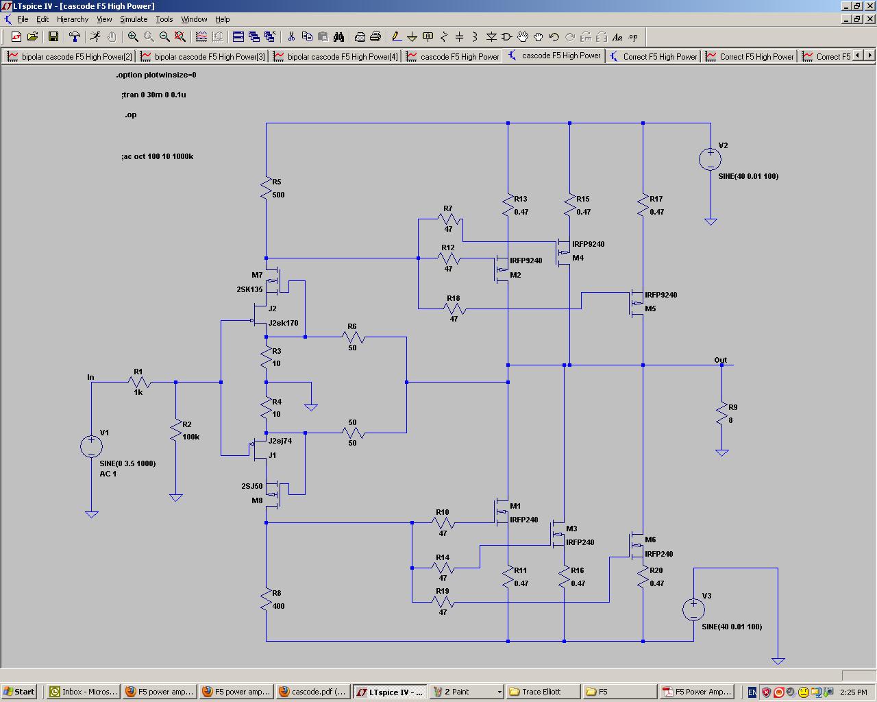

F5 power amplifier

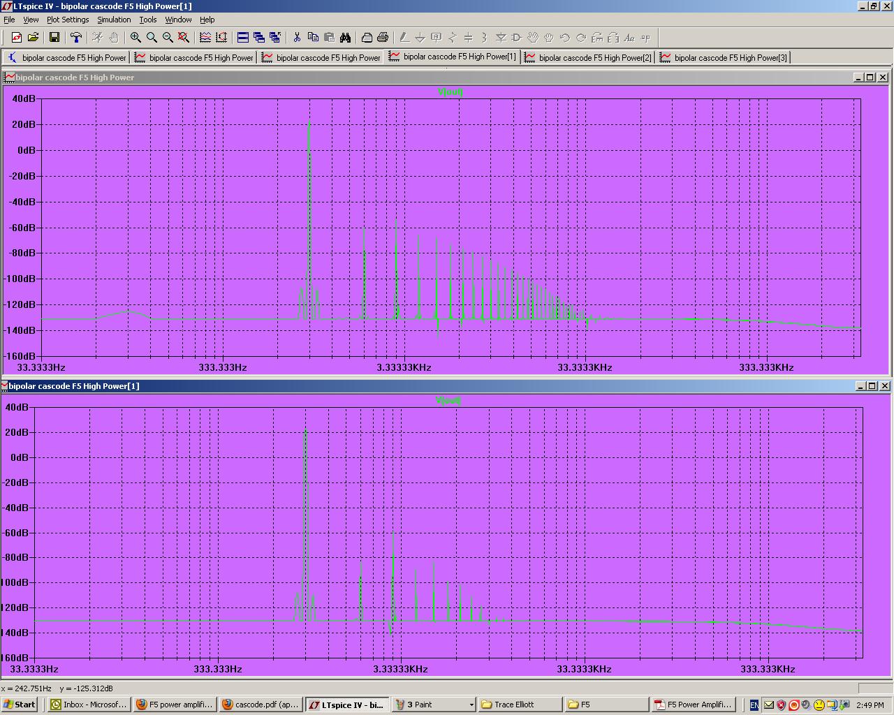

F5 vs Cascoded F5
Bias is 2.4 Amps on both
The top of the screen is the standard F5 and the bottom of the screen is the cascoded F5
The results are for 20V peak into 8 ohms

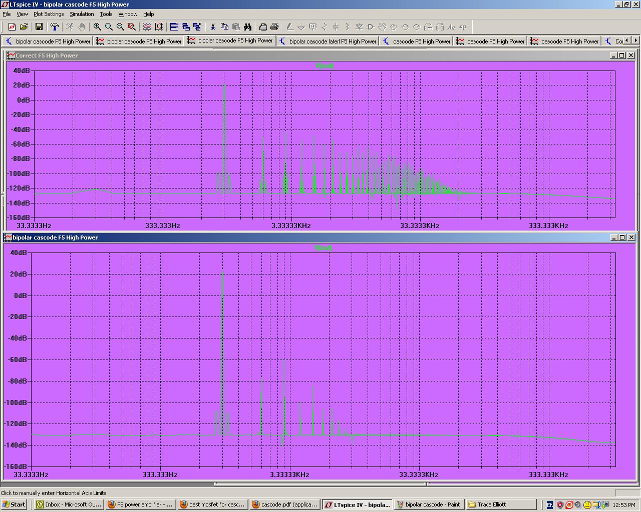

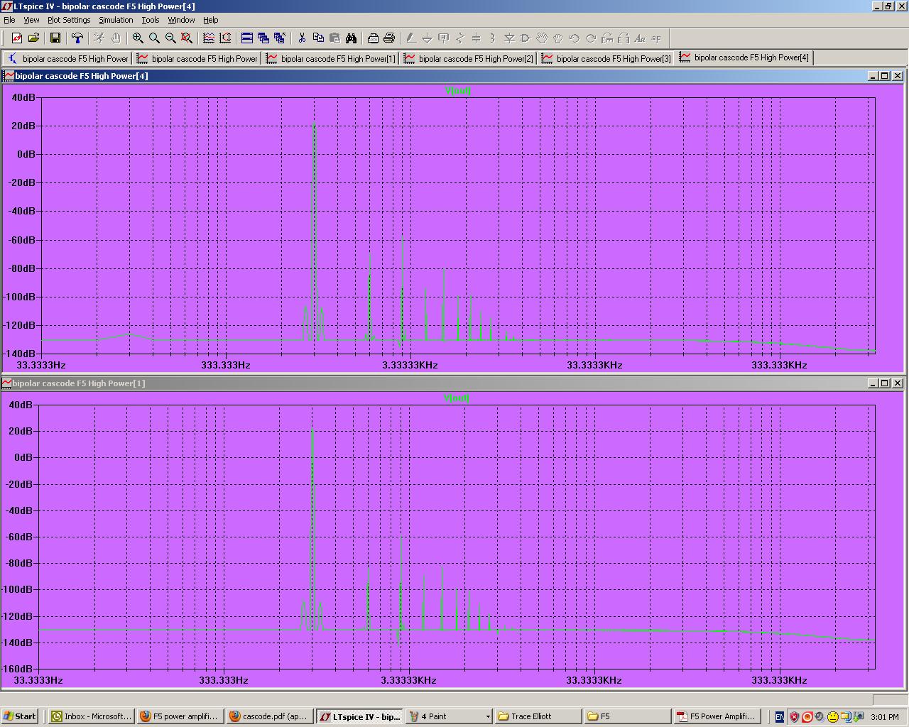

There is a bit of a balancing act with this one. The more voltage you put on the rails the less bias current you can use. There is a point where the cross over distortion is greater than the benefits given by the the cascoded input eg at 20V peaks (or higher) into 8 ohms.
1.2 Amps is the absolute minimum.
2.4A or higher is better but the heat starts to increase significantly with 40V rails.
So performance is excellent at low power output but to get good results (ie better than the standard version) at high power output the heat dissipation will be pretty high.
I hope this makes sense.
Too sum up to get excellent performance at both low and high power ouput you need at least 2.4A and 40V rails.
ie You need 40V rails for improved Low power performance and 2.4A or higher for improved High power performance.

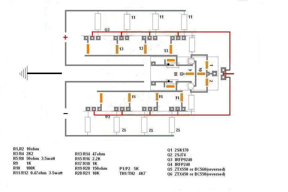

Hello
Can I use 2SJ162/2SK1058 power Lateral mosfet or 2SJ77/2SK214 driver mosfet all original Hitachi ?
Do someone has some layout for the cascode verison ?
For these higher power verison I have two 30-0-30V 430VA toroidal transformers , I would like to give a try!

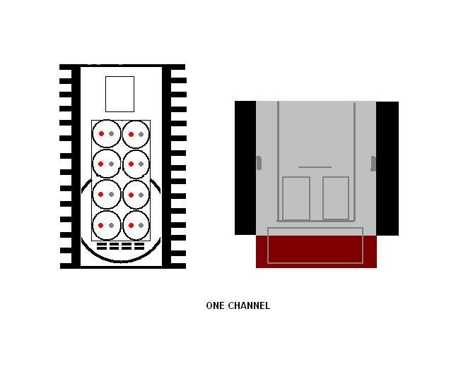

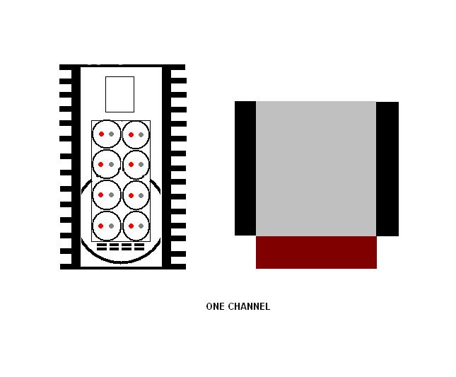

4 output pairs, yes
But I might go up to 6 pairs
Supply is on the picture
Just the trafo is in an integrated wooden base below heatsinks
Supply caps and bridge(double) above trafo
NPN and PNP outputs on each side on their own respective heatsink
Its a mono amp you see
Caps etc is in a inside box to shield from heat
I expect it to give very effective convection cooling on inner side of heatsink
The hot air that goes upwards along inner side will enhance airflow on the outside as well
