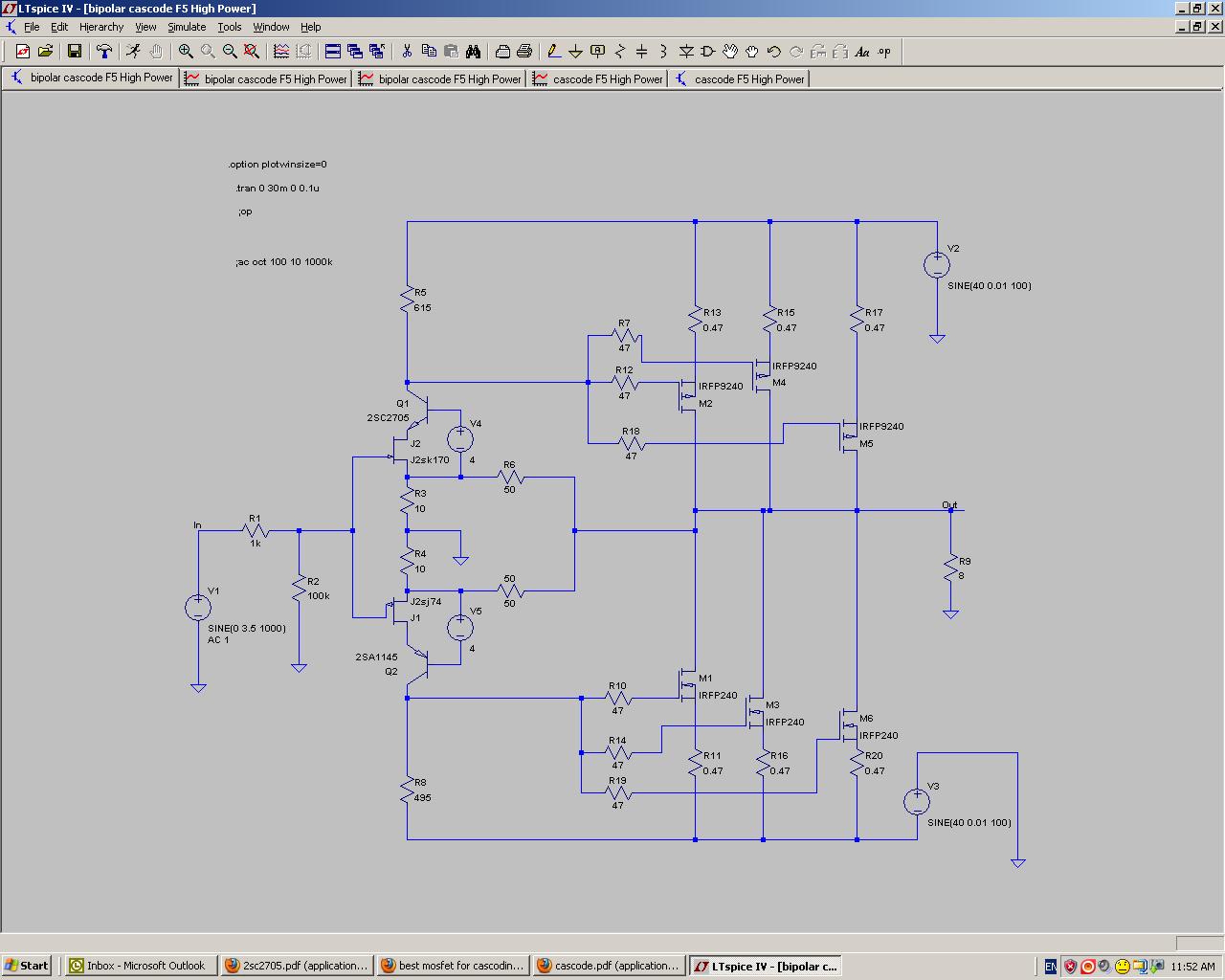

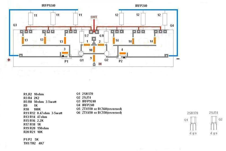

I have searched spec sheet
But I dont understand
2SK135/2SJ50 appears to be TO-3 power devices :scratch1:
