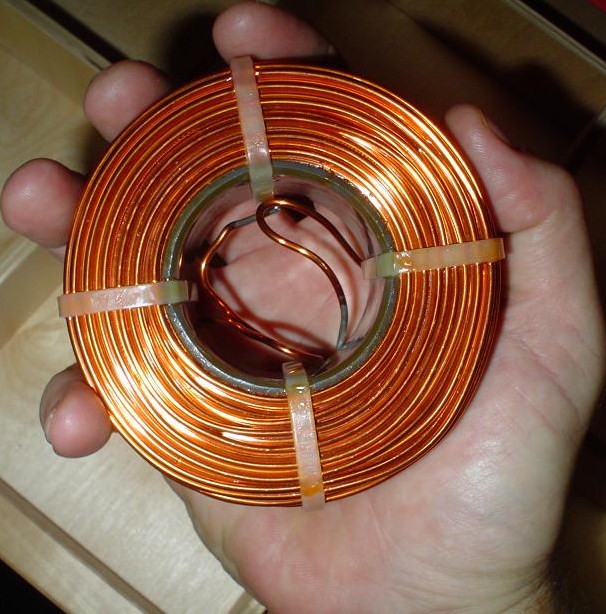

Picture of a 2.7mH/10AWG aircoil, weighs in at +4lbs.
Costs about $115 overhere, roughly 80% of a comparable thingy at North Creek.
(either that, or it's actually tiny and i'm a midget in real life instead of a ftbstrd)
Dream on Dutchy whale 😀
Anyhow, the pic is a bit deceptive.
A wild guess says that the inductor Jaccolina is holding, is on the wrong side of 100mm wide.
Size is most likely going to be the limit of what most here are willing to do.
Magura 🙂
$63.95 each for 2 of these from Madisound:
They don't sport a data-sheet, so I don't know this for sure, but the foil inductors I've come across so far, were made for x-overs, as the insulation (often PP or the like) isn't going to survive the core temp, in a power app.

I would be suspicious looking at the price. At that cost, it is unlikely to be respectable quality magnet wire, that it's made of.
For a cross-over, I wouldn't hesitate using that sort of questionable quality, as the power involved is a fraction of that in the CLC filter.
Magura 🙂
Hi Magura,
How would the quality of it affect the CLC filter?
Next, actually my plan is 4mH-->44mF-->0.1ohm-->40mF,will this avoid some of the problems mentioned earlier?
