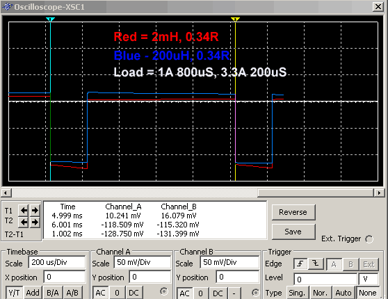

Choke versus resistor PS filter
Excuse me for asking this question again but the first time no on offered an explanation and with the renewed interest in replacing the resistors with a choke ...
Using the DUNCAN AMP PSU tool when I replace the resistor with a choke (with the sames DCR, inductance doesn't seem to make that much difference with values available) I get much higher ripple. Not slightly higher, order of magnitude higher.
As others have said, using chokes is standard procedure with tube gear and I have used them in tube projects, also.
Can one of the more enlightened enlighten me? I suspect a few others would enjoy the explanation, also.
THANKS,
if I were designing a CLC for an F5, I would use 6m8F//6m8F//6m8F as the first capacitor bank, then 180turns of 1.6mm diameter enameled copper on a 48mm air core former (700gms of copper) and then 15mF//15mF//15mF as the second stage capacitor bank.
Here's a simulation of a 2mH choke and a 200uH choke -- switching the load between 1A and 3.3A -- 800uS/200uS

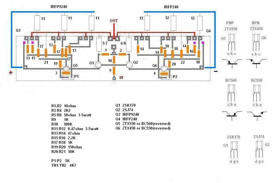

Hi
Here is my new F5 layout with triple outputs
I do have both PDs and CVs F5 boards, and looking at them has helped me some
Still, I like a challenge 😛
Do you think this will work ok
Or is there somethindg that needs changed
btw, Amplimo makes 2x18V, 2x20V, 2x22V trafos 🙄
Could be, I am still trying to find the ideal.
I did my setup with 2 pairs of outputs per F5 channel. I was hoping to bias them at about 1 amp per device, but I ended up at about .8 amps per device before my rail voltage sagged too much - my goal was to stay in Class A throughout the useful range of my highly reactive, less than 4 ohm speakers and get the damping factor up as well. I ended up having the power supply voltage drop a bit as I raised the bias, effectively bringing my power potential down. I had to piggyback a couple more resistors in the power supplies to get the voltage back up a bit, and added some more capacitance to get keep the ripple down, but I ended up with +/- 18 volts instead of +/-24 at the rails. This is with 18-0-18 400va toroid.
I am going to get a higher power transformer and try to get the rails back up to +-22 (or 24) volts and then try again. This is a lot of heat to deal with as well. With the stock value of 1.2 amps per device and a total of 4 devices, everything runs pretty cool compared to 8 devices at .8 amps. with everything biased higher I have to have forced air blowing over the large finned rectifier heatsink to keep it below 70c.
For testing I have one channel set up with .6 amps across each device and one channel with 1 amp across each device trying to see if I can tell a difference in any musical situation. So far I can't tell a difference, but I think that my weakest link is not the amplifier.
Both channels measure well with the measuring software/hardware I have. They have not ever tested identically though.
Hi
I have already done this, see post number #5047 on page 505.
It ran extemely well. You shouldn't have any problems what so ever.
As a comparison it performed significantly better than a Naim amp.
Really not a problem. Just match them up a bit, increase
the Source resistance, and go to town.
Occasionally you will have to think about compensation,
but a cap on the feedback loop resistor will pretty much
take care of it.
Nice respond from Nelson upon my question about multiple outputs
Well, I have some not so clever questions
1. Well, which is source resistor ?
2. And raise value by how much ?
3. Cap on feedback loop resistor, which is that ?
How big a cap ?
4. Power resistors 5,6,7,8, from input to output
They are double 100ohm, is that because they need to be 6watt or just
fore adjustment of value ?
5. Power resistors between supply line and power transistors
Why only 3watt resistors ?
